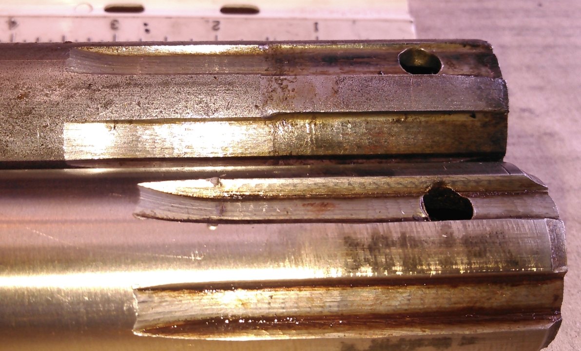

There have been a few times that this has been mentioned in this web site, so I ran across this case and took some pictures of it. There are four pictures of drive shaft splined ends and couplings for a Model TT truck drive shaft. One end is an early drive shaft that came off a Model TT rear end. The early rear end in one from 1918 rear end that has the bead on both side of the housing, the rivet that holds the brake plate on and the back upper cover for the worm gear that has NO oil filler hole. Also, on the upper top backside of the housing there is the stamped matching numbers on that rear end that is 18592, so it is early of the 40,000 or so, that were made in 1918. The other drive shaft came off a later, more common rear end. Nothing special here.
As you noticed the splines on the early drive shaft splined end and coupling are both shallow as compared the later drive shaft. That is something to be noticed if you are getting parts to rebuild your Model TT truck. You maybe disappointed if you got the wrong drive shaft.
EARLY DRIVE SHAFT IS ON TOP in both pictures

[Steven,
I have a few comments/questions:
1. I didn't know there was any difference in the TT drive shaft from 1918 through 1927. My '18 TT has the beaded clamshell housings and it's equipped with the differential shaft and 2 differential pinion gears. The "later" TT's had a differential spider and 4 differential pinion gears. Could it be that the drive shaft change and the change to a 4 gear pinion set-up were done at the same time? According to the parts book the spider was for 1923-27 trucks.
2. Just for the record the TT1 Parts Book shows only one drive shaft for 1918-1927. Of course this isn't the only inconsistency in the book.

There is an article in the Ford Service Bulletins regarding the TT d.s. coupler.

Henry, I do not have any documented information on the different drive shafts or coupler. Just what I have read on the MTFCA forums and the observations of the 8 TT rear ends I have taken apart (4 standard and 4 Ruckstell). It looks like there is some here.
