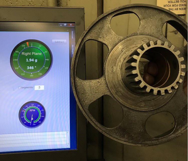

We just finished a transmission balance job for a customer and I thought I would share what we found when balancing the low and reverse drums. I have to say that while these drums were out of balance more than most, these were original Ford drums in pretty nice condition. Most times they are not this bad, but what the pictures are showing is a low drum that was over 40 grams heavy on one side measured at the outside diameter and the low drum was over 20 grams heavy on one side. The pictures show the before and after out of balance. Just thought I would share how much some drums need correction. The brake drum/driven plate assembly was out of balance about 35 grams when we started but I don't have any pictures of that.
So if you are building a transmission for your car, keep this in mind.
Reverse drum before- this is Balancer reading before correction:
Here is actual balancer screen after correction:
And Low drum before:
Low drum after- notice how much material was removed from web:

What method do you use to remove or add weight to balance?
Andy
Re: Should You Balance Transmission Drums
Posted: Sun Sep 20, 2020 7:18 pm
by Allan
I use a carbide burr in my die grinder. Sometimes the casting of the drum is a little off centre when machined originally. if this contributes to the out of balance, I chuck the drum in my lathe and re-machine the inside diameter somewhat to help the situation.

by Tlman
Dan,
Just curious, was core shift or misalignment front to back the major cause of imbalance?
Tim
Posted: Mon Sep 21, 2020 2:13 am
by Dan McEachern
All good points, the bottom line is if you are building a driver engine, balance the drums, triple gears and the flywheel. That goes double for a flywheel with the magnets removed.
Dave N. drums are certainly nice, and because they are not machined from a casting, the are, by default better balanced than one machined from as casting.
The key to removing material for balance correction is to not create any stress risers- as many of us know, the cast iron drums are brittle. With this said, we never drill holes in the web area of a low or reverse drum, either to attach weight or remove material. Brake drums are a little more forgiving and there are numerous thick sections where material can be removed. Rotating the driven plate on a brake drum will many times help with balance, but you still need to check tail shaft runout, and Mr. Murphy says the best balance combination always gives you the worst runout. It's hundred year old iron . . . . but we make it the best we can.
The low drum unbalance in this case was in large part due to the casting not being perfectly concentric with the machined band surface. I could have machined the ID of the drum but they are so thin, I chose to take material out of the web, and only a few grams came off the ID surface to tweak the final numbers.
