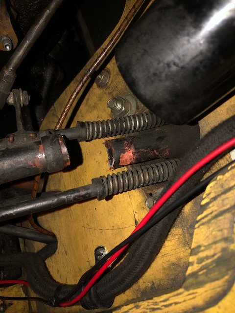

Found the steering issue. Dodged a bullet.
I thought the steering columns were solid.
Now to find a good straight column.

Steve, Looks like it has been cracked for awhile, my guess would be excessive up & down steering column due to a week firewall at the column mounting. By the way I gather you have an early Mustang(s). I have a NY Rusty 6cyl. convertible warranty plate data date July 25th.

Surely the steering column isn’t a piece of tubing! Hopefully at least it was the standard solid
column. But I would never thought a steering column would twist in to like that. The ones I have found in junk yards and farm auctions were used as pry bars, chisels and no telling what but for a break like that I have to say WOW like Norm said!
That copper color sure looks like a piece of hard drawn copper tubing but surely not!
Re: Guardian Angel Found the issue!
Posted: Mon Sep 21, 2020 7:53 pm
by RajoRacer
Not a "FORD" steering shaft ! They are solid 3/4" steel - I just cut one to make a pry bar.

Solid shaft? Maybe the early ones by the look of the throttle lever this car has a Vaporizer Carburetor which would make it from a later '26-7. The wood firewall tells me it has a aftermarket body & not as supported as it was when it would have been in the "Original" car with a metal firewall & column support. My guess old "Henry" always looking to save on the vehicle cost had hollow shafts in the late vehicles. George

Looks like a copper tube to me too. Yikes! Wounder what else is lurking out of sight.

On close inspection I think it was welded together at that point, and the weld has let go. It certainly is not a standard Ford shaft. The weld may ave been filed back into round, thereby further reducing its strength. I believe the copper colour is red primer. Under where the paint is buffed off it shows bare steel. The weld too is broken steel. It looks like the throttle arm is held in place with two cotter pins. All in all, I would be checking everything on that restoration. If that sort of work is done on steering components, I seriously distrust the standard of workmanship.

George H., as frugal as Henry was, he never made hollow steering shafts, which are not columns. A column is what the shafts are enclosed in.
We need more pictures of that shaft, there is something seriously wrong going on here. Clean everything up and take several more pictures. That looks very scary, hope nothing else was repaired that way. JMHO Dave

As an afterthought, I have made most of my living for the past 40+ years as a welder. As experienced as I am, I would never weld two pieces of a steering shaft together on something that would be driven. I have seen many shafts, not just steering shafts, welded together with just a small bevel on each end, and then the weld was ground down to fit whatever, leaving very little "meat" to hold the joint. Several years ago, there were some posts on the old forum about some reproduction early '09 type front axle "yokes" that were made to weld on later axles to convert them to the earlier style. Apparently, the ends of the axle and the ends of the repro "yokes" were just beveld a bit and welded on. Then, a lot of the weld was ground off to look "original", leaving very little "meat" for strength, causing some accidents when the ends broke off. Anything like that should be beveled enough to get at least a 100% weld, anything less is just asking for trouble. As for the steering shaft that has been shown, beveling both ends to get a 100% weld would be much better, but I wouldn't trust it without some close inspection periodically. JMHO. Dave

I was able to pull the top half of the steering column out.
It does not look like it's hollow.
Still does not look like one piece of solid steel.

Somebody welded two pieces together... and very poorly. Why do people do stuff like this.......

That is what is seems, perhaps the builder wanted to shorten or lengthen a Ford steering post, and drilled part way into each piece. Placed a steel rod to act as a dowel, then welded up around the joint. Rather risky for a steering post shaft.

Had the 'dowel' been of smaller diameter, had both sides of the shaft been deeply V'ed, had the weld been made deep enough to pick up the dowel too, then that break may not have happened. But, it is still a modified, welded steering component, which should be avoided. That it was done in such a manner raises alarm bells about the way other work may have been done.
