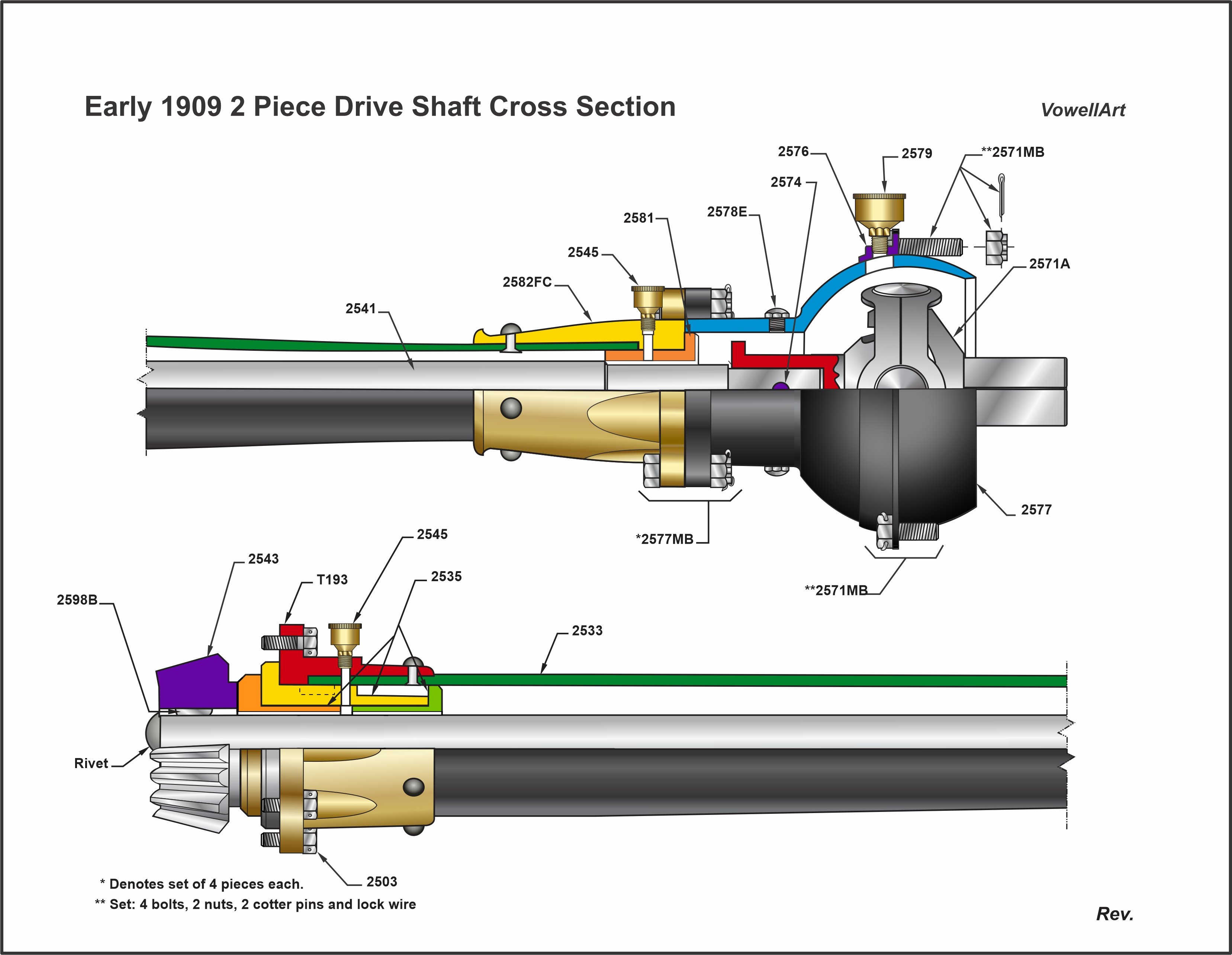

Sometimes with illustration you can't see things as clearly as you can in a cross section. This is a 1/4 cross section showing both the outside and the inside of the 1909 driveshaft assembly.
I've got a few questions though...on the part 2535, it shows in the Ford parts book as one assembly (bushings and housing), which leads me to believe that the bushings are in fact babbit, cast into the housing and then line bored to fit the driveshaft. In which case there would be no outter flange on the back end and in all likelihood the rear one and the front one are just one whole babbit bearing, with a grease hole drilled into it for grease cup 2545 and a long groove that runs the length of the casting for lubricating the shaft. I've noticed from the Ford parts book that there is some sort of groove cut into the bearing face (where the Pinion Bear runs on it) on the top side inline with the grease hole, so that would mean that there has to be a longitudinal groove running from the hole to the faces groove. Does anybody know what this damned thing actually looks like? Because I sure don't, I'm only guessing.
Also Part number T193 is the only number I could find for this part. All pictures of it in the parts book show it as assembled to the torque tube, but the main difference is that in early 1909, it was riveted on and not brazed on as later in that year, it also didn't have a bearing spool as all the years after that did, so the flange/bearing housing I think was bolted right up to the rear axle pumpkin without the use of studs, and then lock wired. I've only seen one example of this in Bruce's Encyclopedia where he noted the same thing, I suppose it could've been somebodies fix also, does anybody know whether or not it had studs or did it have bolts like I show? Also does anybody know if this part is brass or not? I made it brass because it just sort of evens things out and it looks pretty,
. But if it is steel, please tell me so I can make the necessary color correction.
The only thing I'm not showing, but the ear for it is front center of the 2 piece housing, is the radius rod threaded end with nut....do you think I need to show that? I'm afraid it might clobber the drawing and make things a bit more messy than need be. In truth, I wouldn't add the radius rod until I show the driveshafts assembly with the rear axles assembly because that's when you'd mount that if you were putting it together. I've tried to keep my drawings as if you were putting the assemblies together and in the order they'd be assembled to whichever assembly I'm drawing. For instance, Springs are not part of the axle assemblies, they are a separate assembly unto themselves, so if I'm going to show the rear axle assembly, I'll add the springs, shackles (because they're not part of the rear axle either, yet the perches are), radius rods and the driveshaft assembly...problem is unless I do an 11 x 17 fold out it is going (in all probability) really small in an 8.5 x 11 format, unless I do it is two different drawings, one adding the rear springs to the assembled rear axle and one the Driveshaft/torque tube and radius rods, connecting to the rear axle...still sounds muddy to me, but I guess I'll see what happens when I get that far....after Driveshaft comes Frames...yeah that's gonna be fun, there's a truck load of those,
