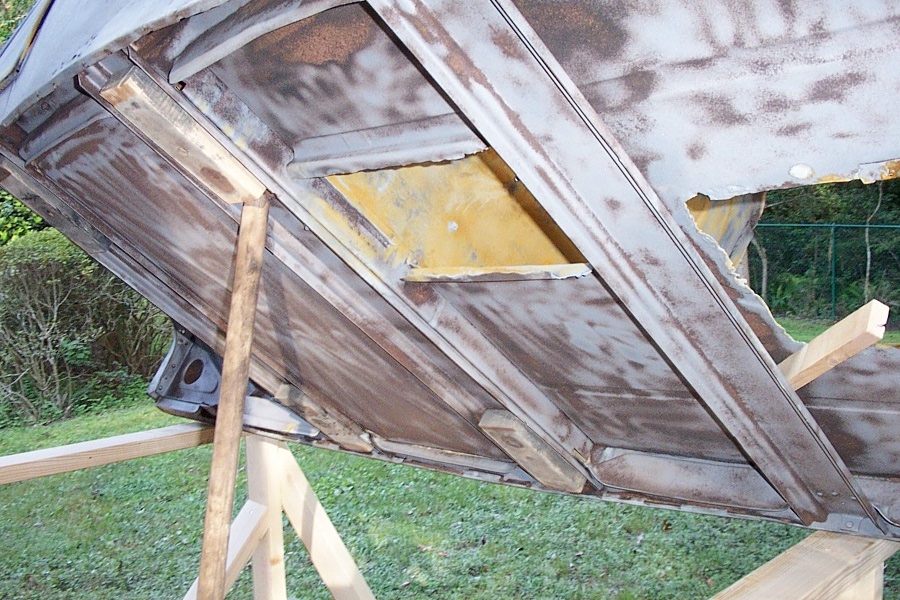

The process is straight forward, locate all the body mount brackets on your '26-'27 frame.
Then place the body with its subframe over the brackets, it first helps to place the wood body block mounts, with holes for the bolts to slip thru the frame brackets.
Note body wood block, mounted.
The bed will mount to the top member of the subframe with long bolts thru the bed flange and the subframe, nuts mount below.
Body blocks used on '26-'27s
