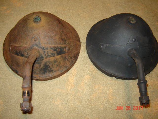

Here’s something to consider.
I hope this photo shows up. See the flat on the lamp stalk where it interfaces with the fender bracket. Some lamps apparently don’t have that! I’m thinking it was for indexing the lamp so it pointed forward, (no c/c adjusting). So do the lamps without that feature use a different fender bracket? Or can they be adjusted to look in the treetops?
I wonder...?
I wonder...?
- Posts: 5549
Re: What headlights for a Canadian 23 touring. Anyone have a set for sale?
Except for the references to the Synoski winner and lens, everything shown so far is common for US cars and is not an indicator.
