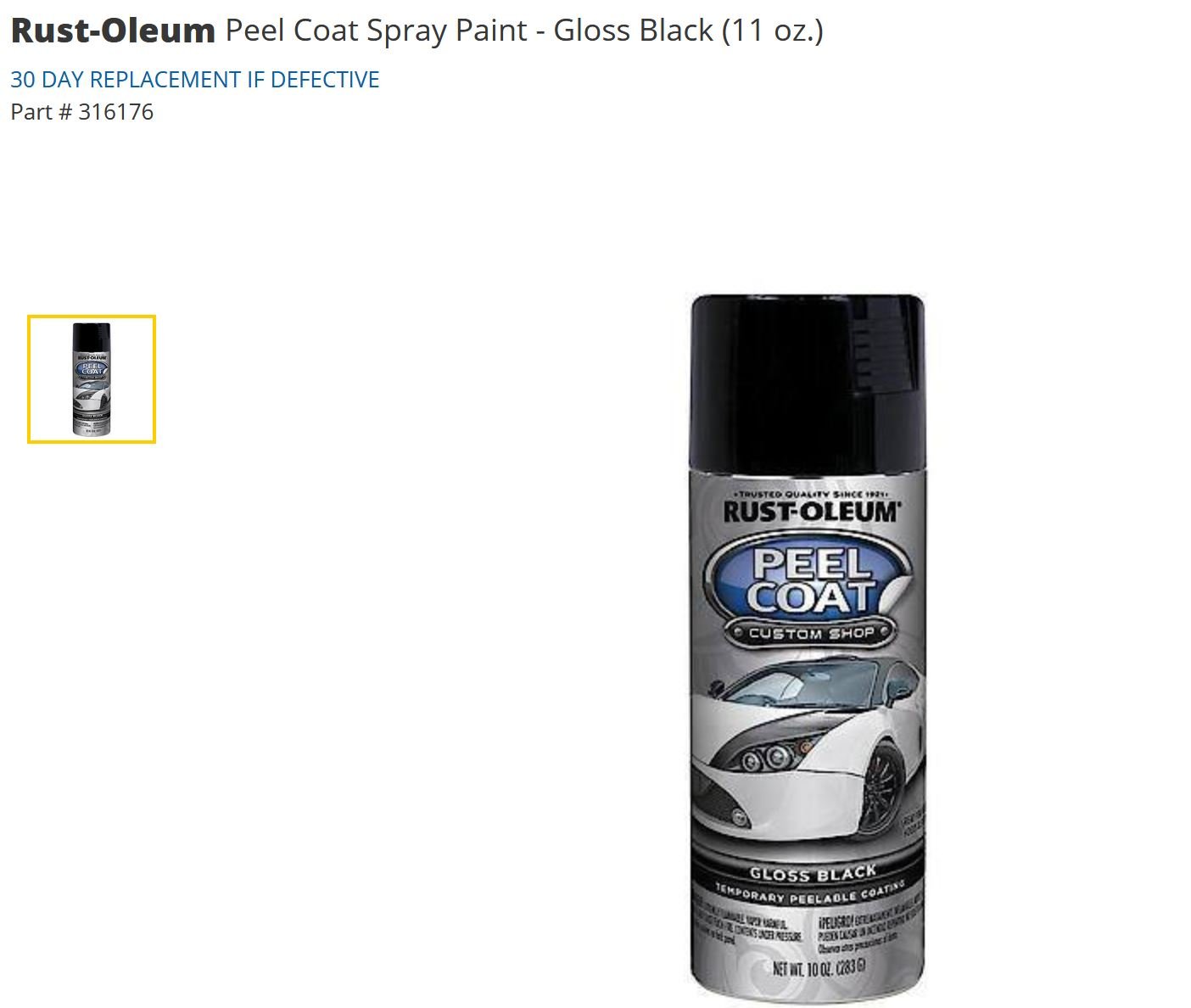

Posted: Wed Sep 30, 2020 1:56 pm
by poorboy1921
Has anyone tried the Rust-Oleum Peel Coat Spray Paint before?
I bought a can and will test to see how it works.
https://www.rustoleum.com/product-catal ... peel-coat/
Wonder if it works as good as it does in the movies...?😉
