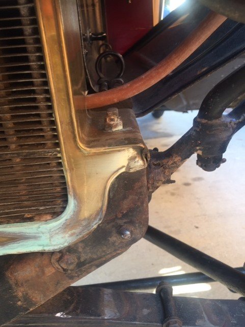

My original 1914 is wide like the brassworks , it has some damage from an accessory bumper mount .

That piece on my 1915 radiator is about 5/16" like yours. One of the reasons I had my radiator recored instead of buying a new one was that I wanted to keep the original look. Another reason was hundreds of dollars. Since then I've seen a few gripes about the new radiators not holding up well under T-era driving conditions. I expect most are OK due to limited driving and/or tame roads.
