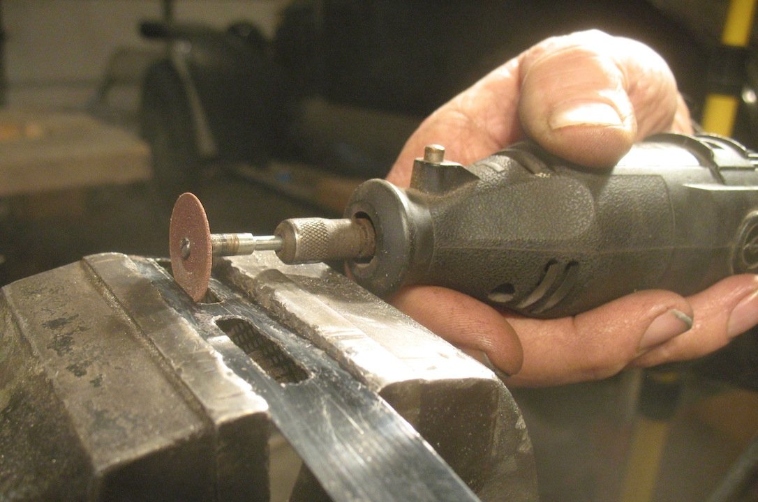

A handy tool is this puller. It pulls the bands around the drums. You can buy it or make it from a piece of pallet strap.
This is what Chris mentioned to avoid dropping nuts and washers into the transmission (a major PITA). Either use one big piece of cloth like a towel, or count the rags going in and coming out.
