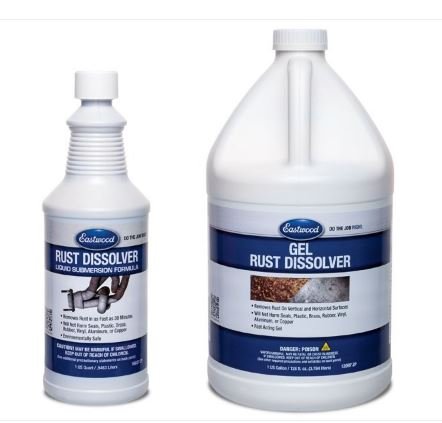

I also heard a lot good words about Evapo-rust. I don't know if some of you ever try Eastwood rust dissolver. It suppose to work really well too.
Also here a video made by a guy who experienced different kind of rust dissolver: https://www.youtube.com/watch?v=CQMzUkEKaBo
I'm currious to heard about your personal experience...

Some research
Basically there are two formulations: One that only dissolves rust and another that bonds to the rust (iron oxide) to prevent further rust
Wikipedia
Commercial rust converters are water-based and contain two primary active ingredients: tannic acid and an organic polymer. Tannic acid chemically converts the reddish iron oxides into bluish-black ferric tannate, a more stable material.[2] The second active ingredient is an organic solvent such as 2-butoxyethanol (ethylene glycol monobutyl ether, trade name butyl cellosolve) that acts as a wetting agent and provides a protective primer layer in conjunction with an organic polymer emulsion.[citation needed] Some rust converters may contain additional acids to speed up the chemical reaction by lowering the pH of the solution. A common example is phosphoric acid, which additionally converts some iron oxide into an inert layer of ferric phosphate. Most of the rust converters contain special additives. They support the rust transformation and improve the wetting of the surface.
EVAPO-RUST®
is a soak and works at a pH of 6.1 to 7 (neutral) through selective chelation. This is a process in which a large synthetic molecule forms a bond with metals and holds them in solution. Most chelating agents bind many different metals. The active ingredient in EVAPO-RUS®T bonds to iron exclusively (the competitors bond to many metals). It can remove iron from iron oxide, but is too weak to remove iron from steel because the iron is held much more strongly.
Krud-Kutter is a Rust-oleum product brand
Krud-Kutter The Must for Rust
The proprietary formulation penetrates into every void of a metal surface and dissolves rust/oxidation through chemical action. Then tiny, rust-inhibiting crystals are formed and become integral with the surface molecules of the metal to resist future rusting. The corrosive agents attack these crystals instead of the metal. Once completely dry, the surface is ready for the next step, whether it be painting, welding, plating, lubricating, etc. Or simply leave the surface bare, and the crystals will inhibit future rust formation.
Krud-Kutter Rustex - Rust Converter
RUSTEX is a rust inhibiting coating which converts rusted metal overnight into a rust retarding, paintable surface. When applied to rusted surfaces, iron oxide (rust) is chemically changed to iron phosphate, an inert, hard substance that turns the metal black. This increases the paint adhesion and durability of the coating.
Rust-oleum Rust Stripper
Take even the rustiest metal back down to a clean, bare surface with Rust-Oleum® Stops Rust® Rust Stripper. Simply apply directly to the rusty surface, wait 10 minutes and rinse with water. Rust will scrape off easily with a scraper or sandpaper
Rust-Oleum® Rust Dissolver
Quickly penetrates every void of metal surface to dissolve rust FAST! The powerful, proprietary formulation takes the hard work out of rust removal and transforms surfaces to like-new condition. It is a specially formulated water-based product designed to dissolve and remove rust and oxidation on a variety of surfaces. It is suitable for use on iron, steel, aluminum, chrome, galvanized metal, porcelain, tile, fiberglass, glass, auto cooling systems and firearms
Eastwood Rust Converter.
This product is a unique rust neutralizer that leaves behind a paintable surface without the need for sanding. Rust Converter stops residual rust, and turns it into a black, protective, ready-to-paint coating, without sanding. Just apply to transform the rust.
Eastwood Rust Dissolver
Removes only the rust, and won't eat-away at the metal itself. Leaves the newly de-rusted metal ready to paint, plate or powder-coat.
Reusable; Removes about 5 sq. ft. of rust per quart
Liquid rust Dissolver works as long as the surface is wet. Items that cannot be fully immersed due to size can be placed in the discharge stream of a commonly available small pump. One gallon de-rusts about 20 square feet of metal. This product is not safe to use on aluminum.
Red Oxide Paint
Red oxide is used in paints and primers as a rust preventive. If traces of rust are present on an iron surface, red oxide paint will still adhere, because it interacts with the surface by forming chemical bonds. Also called red lead, reacts with iron and iron oxides to form insoluble compounds called plumbates, in which lead is part. It is falling into disuse due to concern over lead poisoning.
Re: Rust removal Evapo-Rust
Posted: Wed Oct 14, 2020 5:26 pm
by Quickm007
Thank you Frank,
And what is your recommandations? which one to use ? :?

I have used both Krud-Kutter products and the Rust-Oleum rust dissolver. These are phosphate based. Before I use these I wash, paint strip, de-grease the part, this makes the rust solution last longer since and these will removes some paints. Having said that, my preference is one that dissolves the rust. If the rust is really bad then they type that bonds. In both cases I scrub/wire brush/wash off all the contaminants, let dry and if needed, power wire brush. The first plate is the original rusted one with whatever was on it. The second is it after it sat in a bath and I cleaned off the contaminants (started to powder rust). Last on is power wire brushed. I use end capped PVC pipe to bath long items. Bath time 1/2 hour to overnight sometimes. I am planning to try Evapo-Rust since I found a local source to see how it works.
