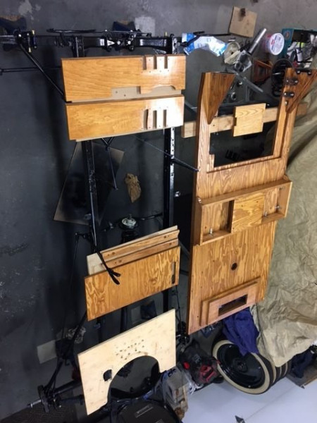

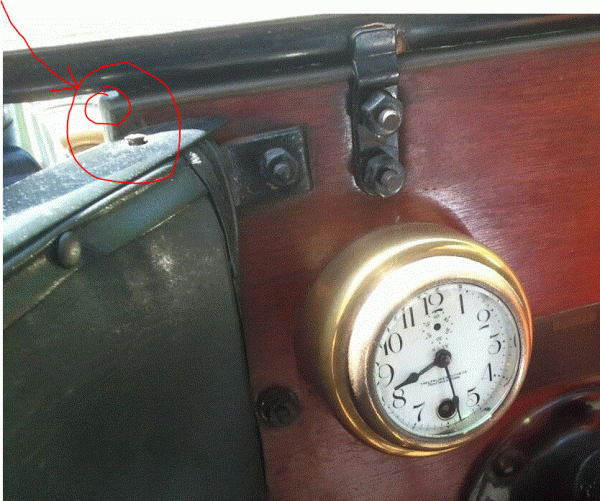

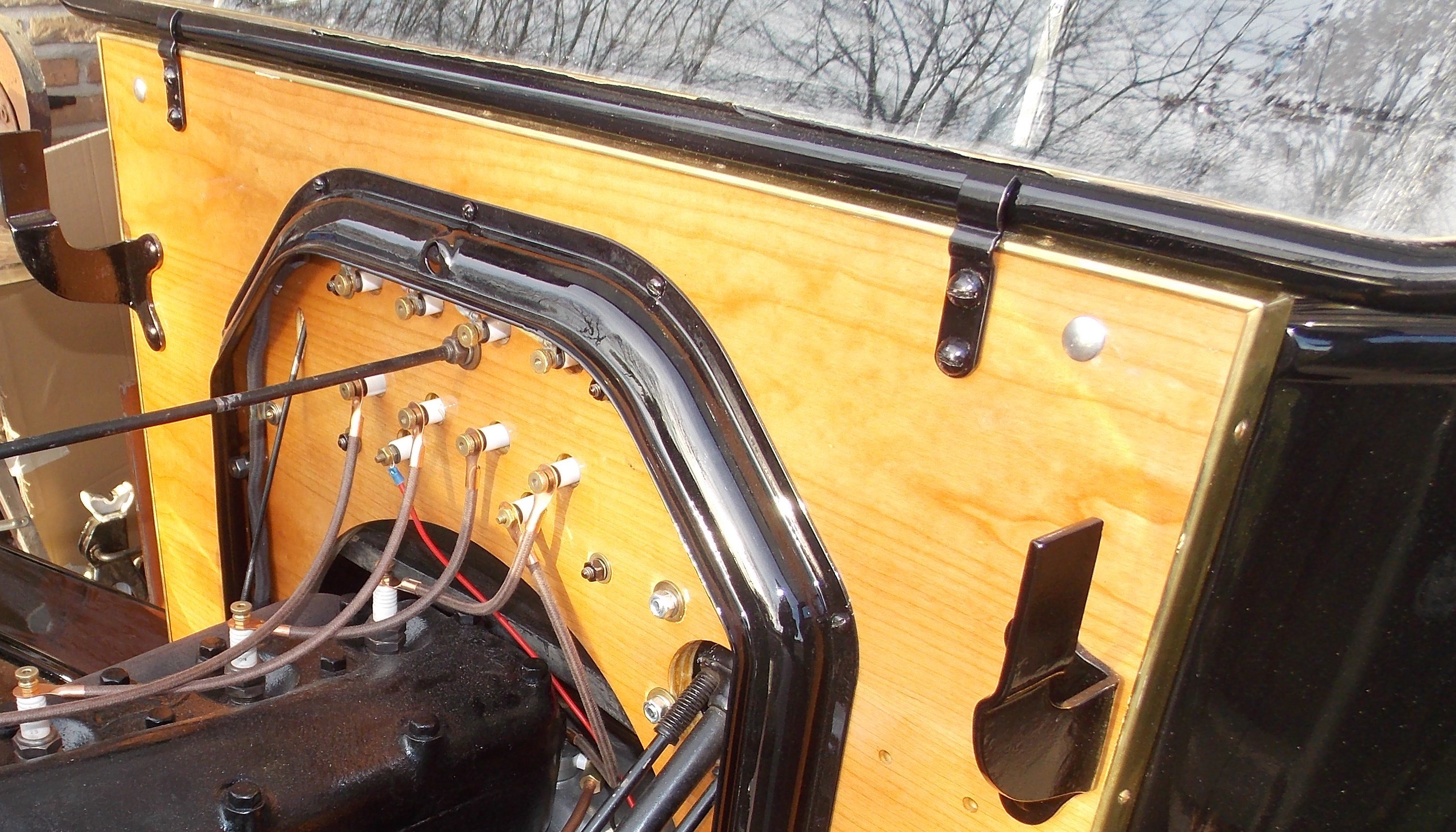

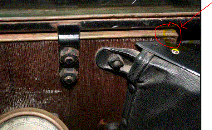

I'm ready ton install the Brass wooden body trim, 3/4" x 1/4" x 60" arround my 1914 fire wall. Any suggestion how to do the 90 degree corner? See bellow 2 pictures I took from internet. The third pictur, is my actual project so far. I would like to avoid cutting the brass at 45 degree if it is possible.

I just notched the two legs and bent the center section. A 90 degree notch with the point just level with the flat center portion worked fine for me.

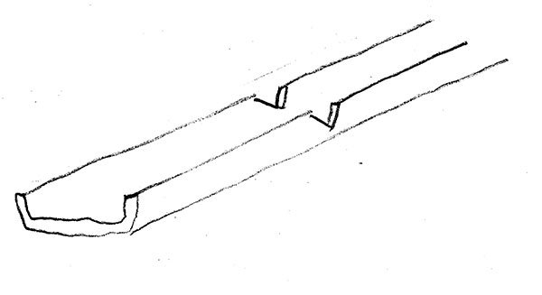

I don't know if this will help?
Andre

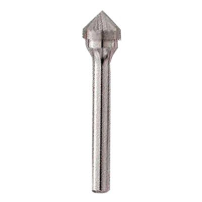

I thought I should post a picture of the tool bit I used. Just make sure it is hard carbide with lots of cutting edges and it is a 90 degree tapered countersink shape like this picture if it posts OK[image]
[/image]

If you’re going to the trouble of doing this on a milling machine and don’t already own a 90 degree countersink; just set the milling head at 45 degrees and use any regular end-mill.. Lock the quill and use the knee to obtain your depth adjustment.

Thank you all for advices. I will take my time for sure and make several measurements in case.

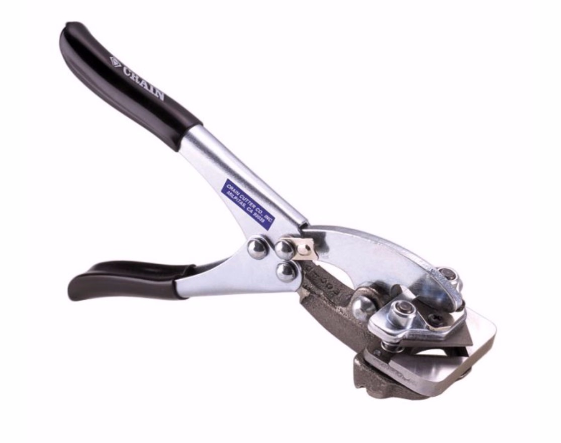

I notched a lot of Brass moldings when I was selling them way back when. I used a metal miter tool like this.
