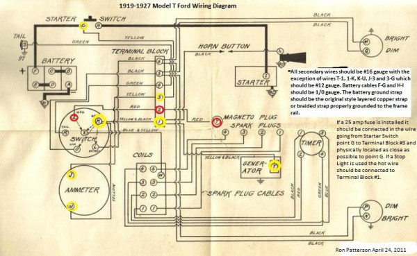

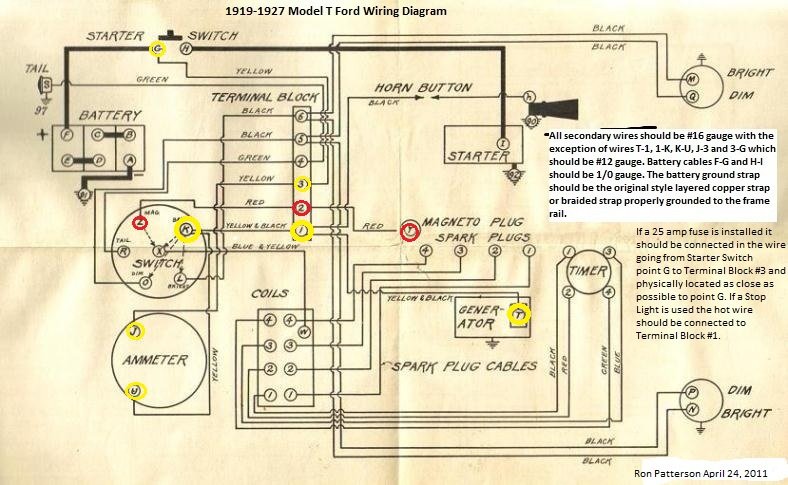

If you look at the wiring diagram yellow connection points show the path from the generator to the ignition switch and battery. The red connection points are fro the magneto. The ignition switch is actually two switches: the key i used to select the voltage source and the lever to select the lights
