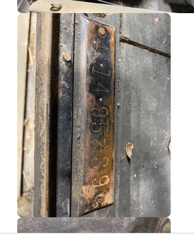

Can someone date an engine for me please
Can someone translate the engine date on this for me?
41495239
Thanks!
41495239
Thanks!

41,495,239 - Are you sure you don't have an extra digit inserted? The highest engine number called out in Bruce's book is 15,176,888.

Sorry, here was the pic

R.V.Anderson
- Posts: 680
- First Name: R.V.
- Last Name: Anderson
- Location: Kennedy, NY
Re: Can someone date an engine for me please
That's a body number, not an engine number; the engine number is stamped directly on the engine block. It looks like the date is April 1914; the remainder is the serial number.

Are you sure that is the engine number? It looks to be attached with pins or nails, perhaps to somewhere on the body? The engine number should be stamped on the block over the water inlet fitting on the left side of the engine. This is not always the original number either, because sometimes the number was ground off and the engine installed in a different car with a different number, or some after market blocks were manufactured without a number and were stamped with the number from the original block. You can look for casting numbers which are raised numbers cast into the block. These numbers will indicate what year the block was cast, but not always the number it was first installed in a car.
Yeah, I asked a seller for the engine number, that is what they sent me. I think they punched that out and fixed it over the engine where the real stamp would be. Thanks for telling me that’s a body number. I thought it looked strange too

But now that I look at it, that is the floorboard!

Here is the link to the engine serial numbers http://www.mtfca.com/encyclo/sernos.htm once you ID the year you can go to the HOME page and get for more info about the model year and differences. The engine number is above the water inlet. Get a picture of it for review by others - easy to stamp a 1 in front to make be another year.
Would that remainder be the same as the engine serial number, or are the body numbers separate?
Seperate; AFAIK no one has developed a correlation between body assembly numbers and engine (chassis) numbers. Not certain you could, actually as the bodies arrived in groups from the maker to the assembly plant, so the numbers could be in any order as they were placed in the assembly line fixtures.

BODY number BODY number!
In the brass era, Ford did not build their own bodies. There were several different companies that supplied bodies to Ford those years. That steel plate is about one inch by six inches, and should be attached on the front seat riser or front floorboard sills. That particular style body number plate was used by Beaudette (otherwise sometimes called Pontiac in Ford's records), and maybe one or two other companies (still being researched?). Those numbers were used for bookkeeping and quality control, and have no other official value.
Before about 1926, the only place the engine serial number was put was on the engine itself. And it is the only serial number originally used for vehicle identification. Which created unanticipated problems when engines were replaced.
My 14 Touring has a Beaudette body number tag as described by Mr. Sheldon and similar to your body tag pictured. Interestingly my body tag is also a 4.14 date and my engine serial number is a build date of April 21, 1914. The kick panels on both my front and rear seats also have a "B" stamped in the top center of the sheet metal panels.
That tag is under the front seat where gas tank is. Sometimes that info was stamped into the wood, sometimes on a tag. Depends on who made body. Dan

It's a body number from an April 1914 body...
