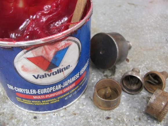

Any good quality brand of red grease does the job for the Ford ;)
IMG_8755 (580x435).jpg (128.63 KiB) Viewed 5485 times
Note the labeling, if this grease works for foreign cars, then it is just fine for The Universal Car!

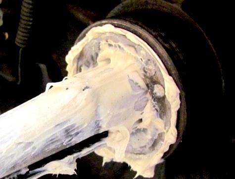

Respectfully, your experience with white Marine Grease for bearings may be good, but my experience is the white stuff is prone to 'cake' drying. Likely due to the large amount of sodium soap used for thickeners. The thickeners are placed in Marine Grease for extra moisture resistance.
Had used it on rear Hyatts only once. After 2 years of touring, pulled the Hyatts for re-grease and dang, that white grease was cake-hardened, and was firmly caked to the roller ribbons. Was tough to clear out. Re-greased with trusty all purpose Red grease.
IMG_0425 (800x600) copy.jpg (50.6 KiB) Viewed 5249 times
