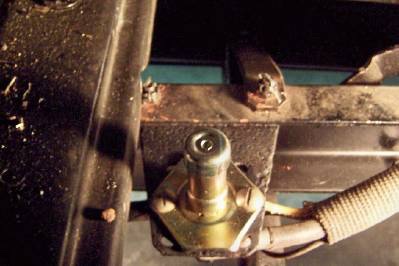

This is a factory switch mount on a 23-24 frame. What type of switch was mounted on it? I have not seen this bracket before. Thanks for any help

I think Gail Rodda pointed that kind of switch as used early in starter production in 1919 back when I was a kid. I wish I had written everything down those older guys said back in my teens.

Likely the 1919-1920 early switch mount. Photo from Bruce’s book.

I used the frame hole count and hole placement to date this frame. I thought it was 22 1/2 to 24 model year by the chart, but now I will have to recalculate my thinking. Thanks for your help.

Another photo off prior forum post of a 1919 -20 frame with this riveted mount for foot switch. Yours seems bit different .

I went and took a look at a 1919 non starter touring a couple weeks ago that had that same bracket riveted to the frame.

Here is a photo of the switch in my late 24 Coupe. As you can see there is no extra bracket on this car and the switch bolts directly on the frame. I also have another switch that was used I placed next to the one in my car. They are almost identical. The switch was in the car when I got it it in 1958 and seems to be original for the car. Ford must have used several different styles. This on eliminates the use of an ‘extra’ bracket so maybe this was a cost and time saving style that was used. It would save the extra step of riveting the bracket to the frame. Another detail is the frame has the four hole ratchet bracket riveted to it. So it’s a 24.

Lang’s sell a well made replacement starter switch that has the offset bracket attached to it. This is only a guess but by looking at and enlarging the picture of it you could remove the switch portion and mount it on the earlier style frame mounted bracket. You might need to drill two holes to mount it but it looks like it might work. But it’s just a guess of course.

Here are the various foot switch used on the T. Maybe more styles, but one shows riveted bracket type.
Photo taken from old forum post.
Once used a Tractor Supply Co. switch sold for universal use. Drilled holes in the std.later bracket that bolts under the running board bracket brace. Of course the early frames didn't have that type of running board brackets or holes, so the early foot switch bracket is riveted to the frame.
One could adapt a modern switch like the TSC to save the original bracket.

My later 1921 has the open style. I do not recall changing it out when I did the chassis. This one is bolted on. In the photo I moved it to the topside of the frame, even with the extension it was too low for my application, normally would be mounted to underside.

I would use a Cole-Hersee #9060 or equivalent. C-H are the best quality I have seen. They look like the previously mentioned switch from Tractor Supply and might be the exact same one they are selling.

Go to Yesterday’s Tractors and go to 9N Ford tractors. They sell what they call a 9N restoration quality starter switch that has 2 3/4” hole mounting spacing that’s really close to the T frame bracket holes. Almost a direct mount.
