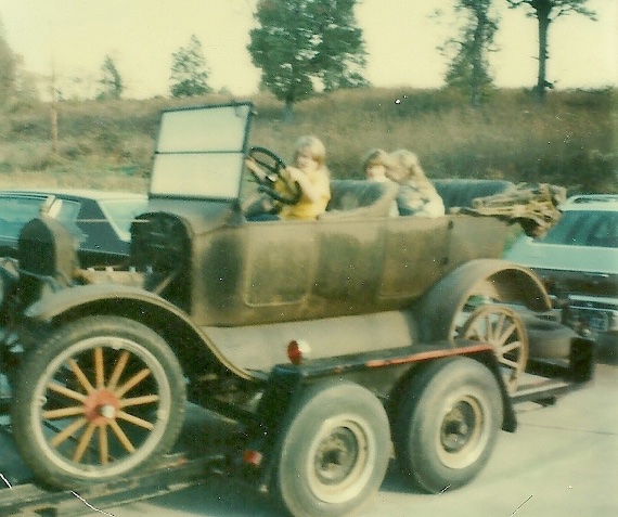

Reminded me of the one I found in 1978, in a barn, was only missing a hood and front wheels, added a set for rolling it out to my trailer.

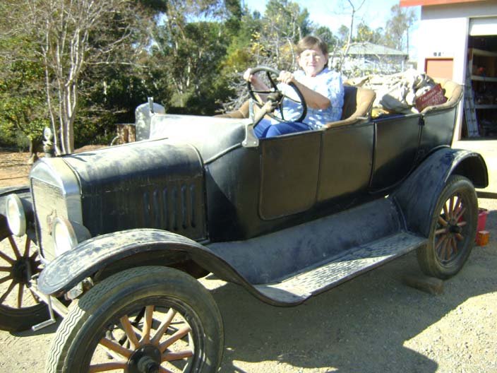

Here is one in my garage now. Since the picture was taken I have put on a new top, but when the new top gets dirty, it will match the rest of it. This car was put in storage in 1991. The owner wanted me to fix it up but do no body work. The upholstery is not original, but not worn out either. The wood is a bit loose, but usaeable. I did install a rebuilt Ruckstell and Rocky Mountain brakes which the owner had in their basement. We had to replace the gas tank and fuel line, but I was able to clean the carburetor and change the oil and coolant. It runs very well and has good power. I did have to take up the connecting rod bearings. It is about ready to go home. The windshield has also been installed and the wheels changed to the proper size wheels.

BE-A-U-TI-FUL!!!

Norman’s refreshed T will look great too. An original T is what it is and it’s only that way once. When they are found is good original shape and close to being drivable a refresh is the way to do it. After all when T ‘s were new they only looked that way for more or less than a couple of years if that much.
