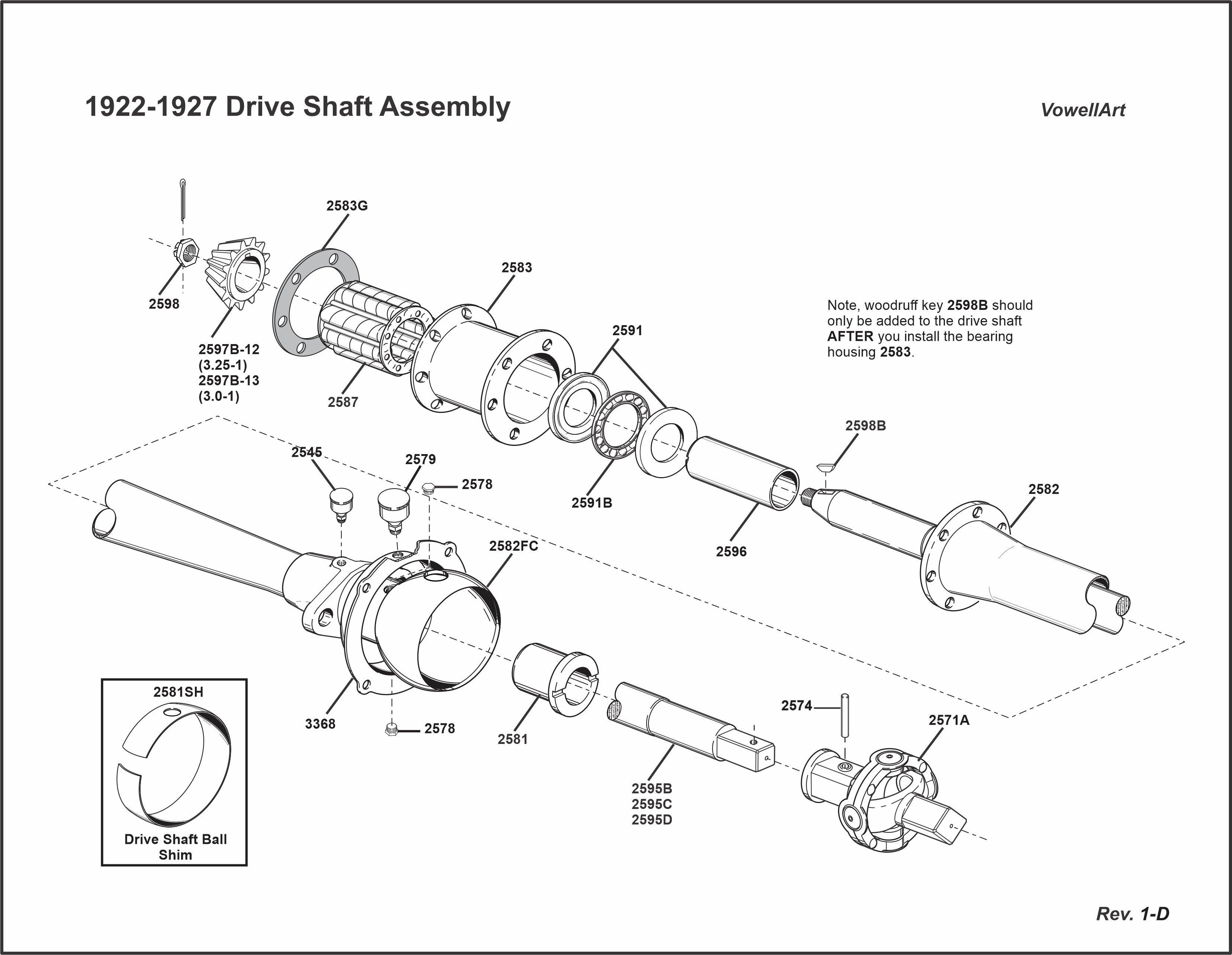

Here are a couple of Martyn's details. The drive shaft housing may not fit onto the open spool without modification.

Posted: Sat Nov 21, 2020 12:27 pm
by Original Smith
As mentioned above get the housings straightened. Even the late ones bend. In the illustration above it shows a gasket between the D.S. roller bearing spool and the rear end. I don't believe Ford ever offered a gasket for that application.
