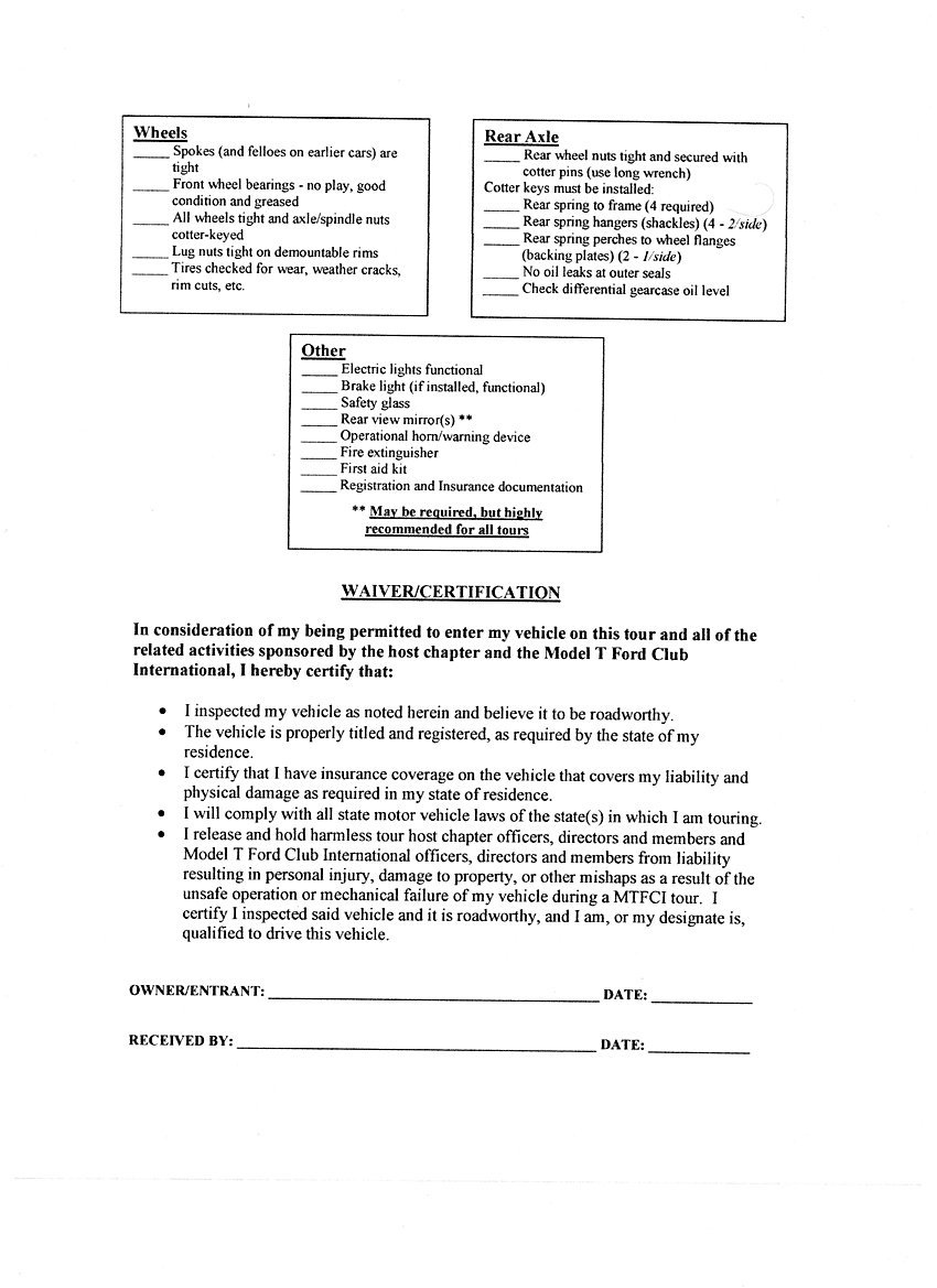

I agree with all the advice so far. I gather you have studied the years enough to know you want a 1923. If you're not thoroughly familiar with that year's distinguishing features, study some more. It's very common for these cars to be titled and registered with the wrong model year. That's usually an innocent mistake. People misremember what they're told or get otherwise confused, or don't understand the difference between model year and calendar year. I bought a "1922" TT that turned out to be a 1924. My 1923 touring was sold to me as a 1922. The next time I bought a T I had studied enough to know that it was really the year advertised.
Another check you can make is whether the steering is tight or needs a lot of TLC. If you jack the front end off the ground, grab a wheel and shake, do all the components flop around? Is there 2" or less steering wheel play, a lot less, or a little more, or a lot more?
You won't use everything here, but some of the things on the club safety checklists would be good to check.
These may help too: http://dauntlessgeezer.com/DG99.html
http://dauntlessgeezer.com/DG90.html
This page suggests some places to sell, so they are also places to look: http://dauntlessgeezer.com/DG100.html
What you want for under ten grand is not the least bit crazy. it should not be hard at all to find a decent 1923 that fills the bill.

Steve,
Thanks for the safety sheets! That will surely help when I find one I like enough to inspect.
I do not know all the minute details between model years yet.. but I did just order the judging guidelines from Langs.
Are there any obvious things to look for to make sure it is in fact a 1923?
