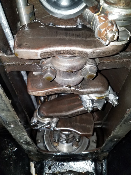

Last year I repaired an engine that broke one of these. Ripped the rear wall out of a 1912 block. I had to have Lock n Stitch repair it. Then I put in a Scat crank. Don’t put one in a valuable block.

Allan and Eric, I had the same break in the back of my '12 block. Darn near didn't see the hairline crack during the rebuild. I'm still running that repaired block with a Bill Dubats crank but have another spare block.
I don't believe the crack existed before the crank failure although possible. Don't think there any blocks with the single gusset after '12?

Even if the block were cracked first, the main cap bolts should hold everything together well enough to prevent a crank failure, However, the crank breaking between the middle & rear mains would create some excellent leverage to break out the rear block web as the broken crank still turns but is now unsupported in the center area.Allan wrote: ↑Wed Dec 23, 2020 4:00 pmEric, I wish I could see photos of the broken out rear web in that 12 block. That would make 4 early blocks I know about with that same problem. Broken crankshaft + broken block on 3 of them. The fourth was a severely cracked block either side of the rear main web. I believe many of these failures, and I have seen it in later blocks too, happen when the rear web breaks loose and this leads to the broken crankshaft. They need to be examined closely at the break site. If the block has cracked before the failure, there will be signs of the crack in the casting 'working', before the final, sharp breakout at the last end of the cracks.

Jerry, can't say I've seen it work that way, when the back of the block breaks, it takes the bolt boss and all out.

Jerry, the land which takes the rear main bolt heads is machined with a really sharp right angle against the back web. This creates a perfect stress riser. On three of the blocks I have witnessed, including one 1923 model, the cracks emanate from this machining and work out from there, So the bolts and the whole web break out as a big chunk.
I wonder if the same problems would ever occur if that machining had a radius against the block.

I have broken two crankshafts in the same block.
The first crankshaft broke as we were climbing Mount Hood on a MTFCA Tour out of Portland.
The fracture was on the front radius of the rear main. Other than some crunching noises and no power transfer to the
transmission there was little damage. With new (reground) crankshaft, re-babbitted mains and I was back on the road.
The second break occurred while climbing a long hill. This fracture occurred on the number four rod throw.
When the engine made its second revolution after the break the whole back of the block pushed back and broke out.
If you think about the brute force and leverage transmitted to the rear web of the block by this type of fracture
there is nowhere else for the metal to go. There were no old cracks from the first failure visible. While failures of the type may appear to propagate from a particular area, in my opinion, nothing can be done to prevent the web fracture when that broken crankshaft's rod pin comes around and hits the remaining portion of the crankshaft.
The first break made a pretty good popping sound; the second was much louder and violent. It shifted the pedals around as well.

Harry, let's hope it is third time lucky with that block! There may well be block breakages as a result of a crankshaft break. I guess it comes down to the luck of the draw at times. However, especially on the early blocks, cracked blocks do give way as I described. I bought one 1912 block, and found 3" cracks either side of the rear main. That example was obviously pulled from service before it gave out. Welding saved it. The 1923 block let go before being pulled. there were clear signs that the ends of the cracks nearest to the machined land were moving/polishing against each other prior to the clean break at the outer ends of the crack as it let go finally. I know of two other early blocks where the same thing happened.
I mention this whenever the ' broke a crank and it broke the block' comment is made, to alert folks that it may well have happened the other way round. It helps to make others aware of the need for close inspection/crack testing of blocks, especially early ones, and especially in the region of the third main bearing tunnel/web.

One is crankshafts breaking and forcing the rear web, the Second being cracks forming along the web of the rear of early blocks.
