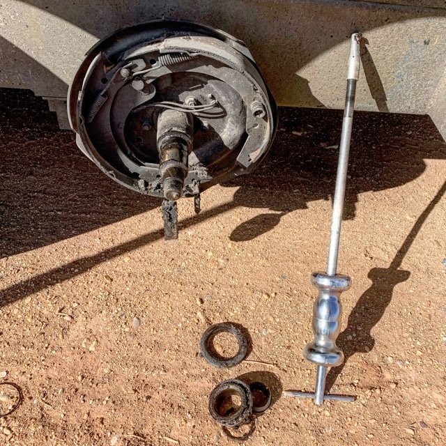

The day after Christmas as I climbed up I-17
out of the Verde Valley towards Flagstaff
I noticed my rear trailer wheel smoking
on the driver side of my tandem axle trailer ⚠️
My trailer wheel is too young to smoke 🚭
I found a trailer parts store to open in
Flagstaff and paid the expected markup
for a new drum and hub - brake backing plate
assembly and wheel bearings for that wheel 💰
I made it to my diesel mechanic & friend
Rudy in Winslow - I had already made an
appointment to change out my front brake pads.
While Rudy changed out my brake pads
I took care of that wheel - then we proceeded
to change out the brake backing plate assemblies
and service the wheel bearings on the remaining
three wheels.
My trailer is three years old.
Once a year I replace all off the brake backing
plate assemblies - wheel drum & hub assemblies
and wheel bearings.
I had done this nine months earlier.
The wheel was not lost - the outer bearing race
had come out of the wheel hub assembly and
had been spinning along with the wheel bearing.
They fused together and as they worked their way
out to the end of the spindle - it formed a ridge.
That ridge kept the wheel from falling off.
The smoke was from the wheel magnet
burning up and melting 🔥.
This is the second wheel bearing race that has
come loose from a factory wheel hub assembly
that I have had to deal with.
The other was a few years ago on the inner
bearing on a passenger side wheel.
I have been told it is a quality control issue.
The wheel bearing drum assembly casting
can be slightly ovaled or out of true round
in manufacture.
This can cause the pressed in wheel bearing race
to come out of the wheel drum & hub assembly.
These were Dexter factory wheel drum & hubs.
FJ

This same sort of thing is also real common in original, used T front wheel hubs. If you set up a dial-bore-gauge and measure all over the inside of the bore, you can easily determine if the bores are properly undersize and properly round for correct fit of a new race. Many times, you will find a bore that is properly undersize at a few points, and a little too oversize at other points (out of round). If you press or drive a new race in, it may feel properly tight, but maybe won’t stay that way very long.

I suspect that the majority of these type of failures are caused by the bearing adjusted too tight. A grease lubricated tapered roller bearing should have at least .001 inch of endplay.
The reason GM and other vehicle manufacturers started using non-adjustable preset wheel bearings is because the bearings were not being properly adjusted when serviced.

Tight wheel bearings will cause problems with overheating and failure. It is better to have a smidgeon of play than trying to tune your adjustment to take out any play. The same goes for T wheel bearings. Leave them a little loose before tightening the nut, and then check again to see if they are still a little loose. If not, back off the nut, wind the bearing out a little and repeat, until you have that smidgeon of play. Just make sure that the play you are feeling is not slop in the king pin bushes.
Hope this saves some problems.
