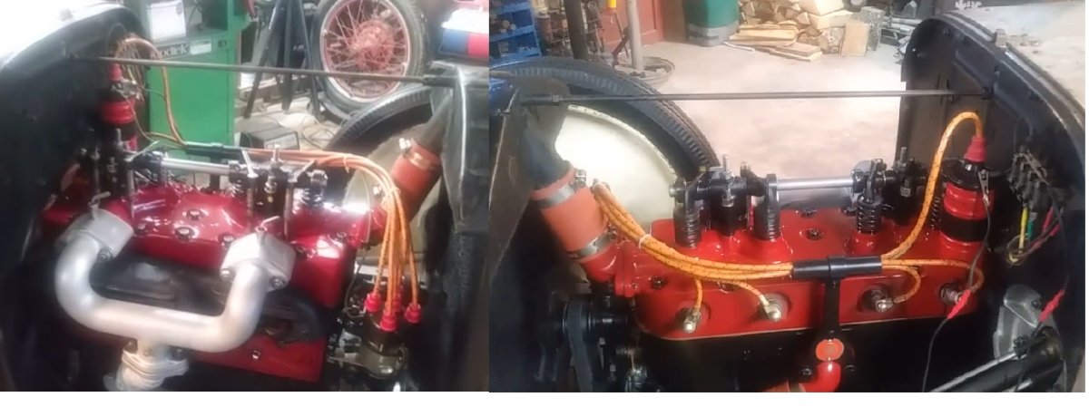

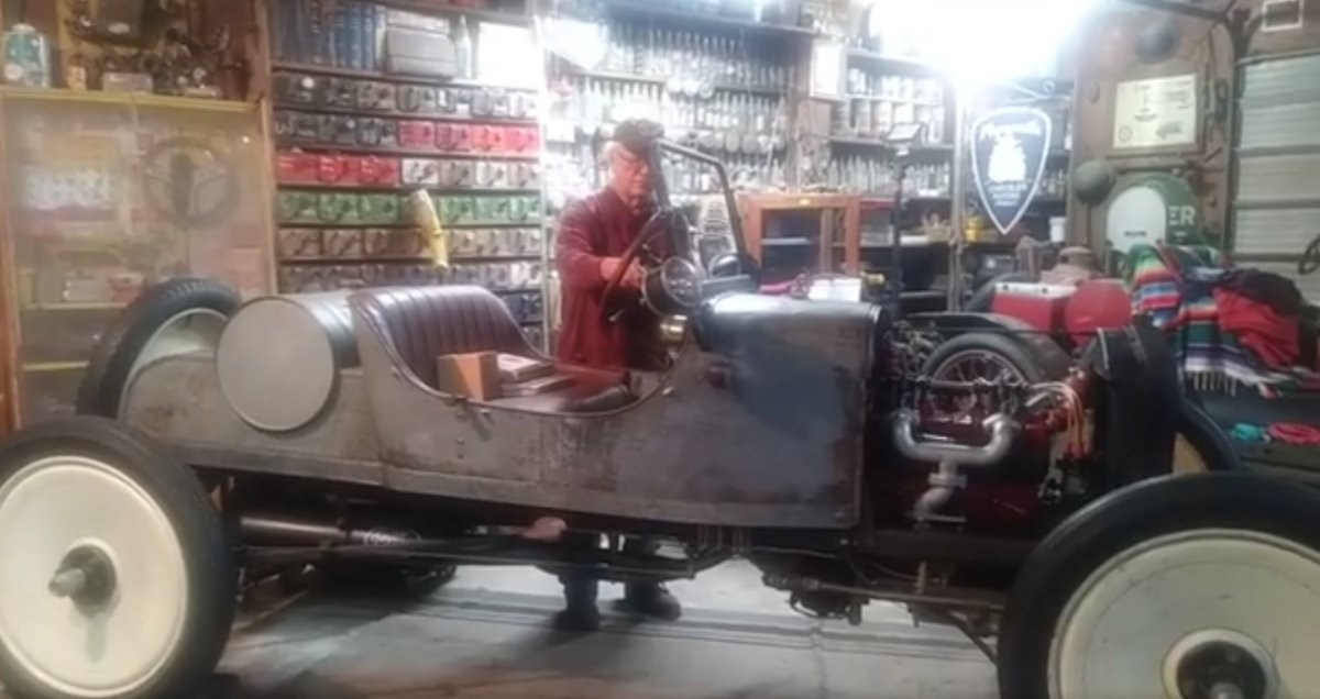

Well the speedster project is running again. Im going to try and post a link to a video on Facebook. This may be a wasted effort :)
post update:
OK, It appears to have loaded the video, but I have no sound when I click on the link, but my wife's cell phone does ??? If for some reason others do not have sound, All I can say is this thing does not sound like a T in any shape or form. It sounds like a race car ... I still have a little hesitation and an occasional "miss" that I need to chase down, but the throttle response is crazy. With the "Taylor Loudspeaker" dual exhaust muffler/cutout, "Stan Howe" rebuilt OE1 Stromberg carb, American Bosch front plate distributor, bare "magnet free" flywheel, 290 lift camshaft, and I almost forgot, a Rajo 4 valve sitting on top. This thing sounds dangerous ..... :) :) :). If you have sound, the video does not do justice to how this thing sounds ...... A few of you please let me know if you have sound. If not Ill try and chase the problem ..
I have started the engine about 8 times now. I had to re-torque the head 5 times after cooling overnight five times. Before the torque stayed at 50 ft lbs. The last 3 torque checks has not moved any. So Im hoping the head gasket problems are behind me...

Sounds & looks awesome! Need to sign-on Facebook - not sure if you need to set the video for PUBLIC (but nothing else)
I captured a few images for those that are Facebook challenged ;)

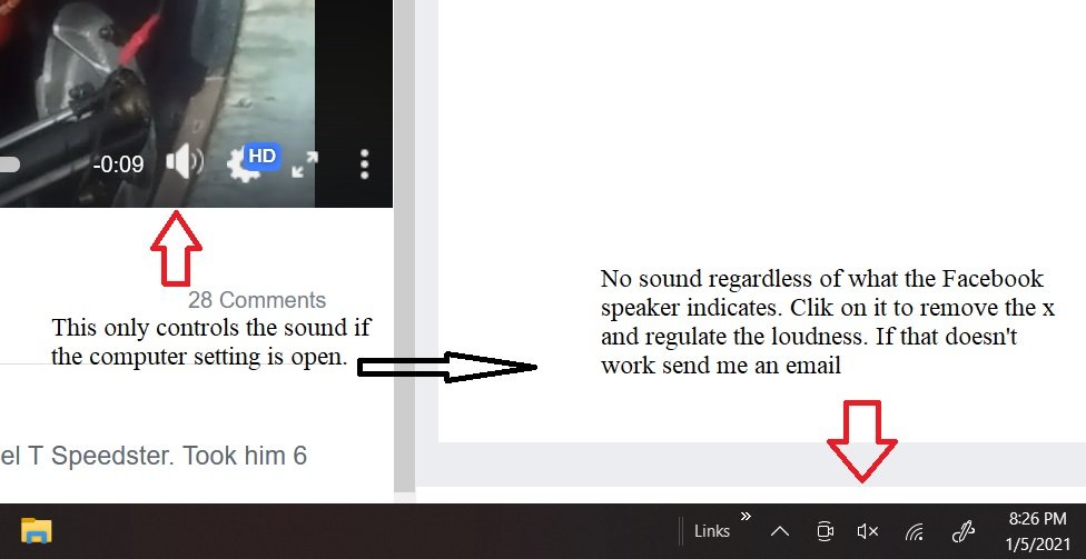

As far as getting sound - there are some settings that need to be in sync to get it. Not sure what Computer/operating system your using (Windows 7 , 10 ?) If Windows 10 then this picture should help
