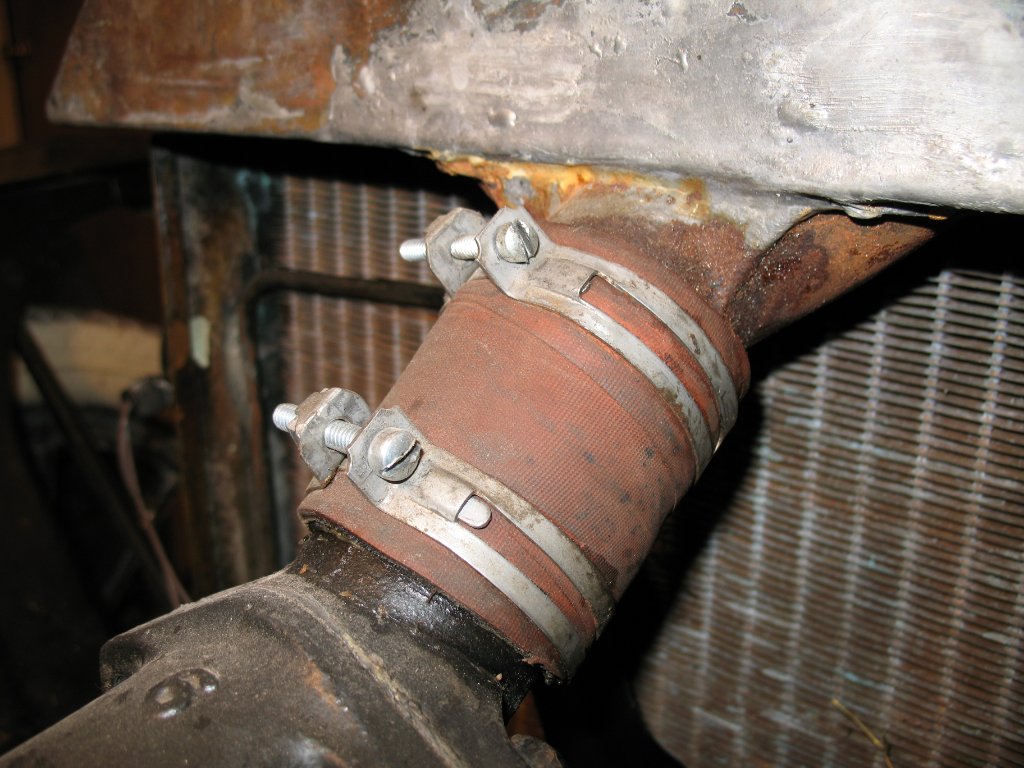

Steve's photo shows the problem using original clamps can cause. Notice the 'hill' pinched in the hose between the clamp lugs. If that causes a leak, applying more tension to stop the leak makes the 'hill' higher and the problem worse. That little sliding strip which is supposed to keep the 'hill' in check is nowhere near as effective as a worm drive clamp. I'm with John on this one. Use modern claps first, and replace them with 'correct' ones once the hoses have settled in.
