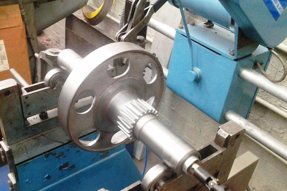

Going to balance my transmission drums and would like to see what you have used...

by RajoRacer
That's what I have & use for any part that rotates - mine is a Sundstrand balancer.

by Dan McEachern
