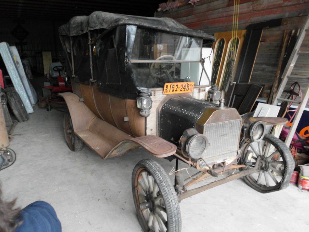

My 13 has no fasteners on the windshield but one on the firewall on each side and on the top. These are the only pictures I took after I put one side on that was under the rear seat of the car that had been parked since 1928. Someone has put black material in place of the clear on the front side window over the years back when these were in use.
