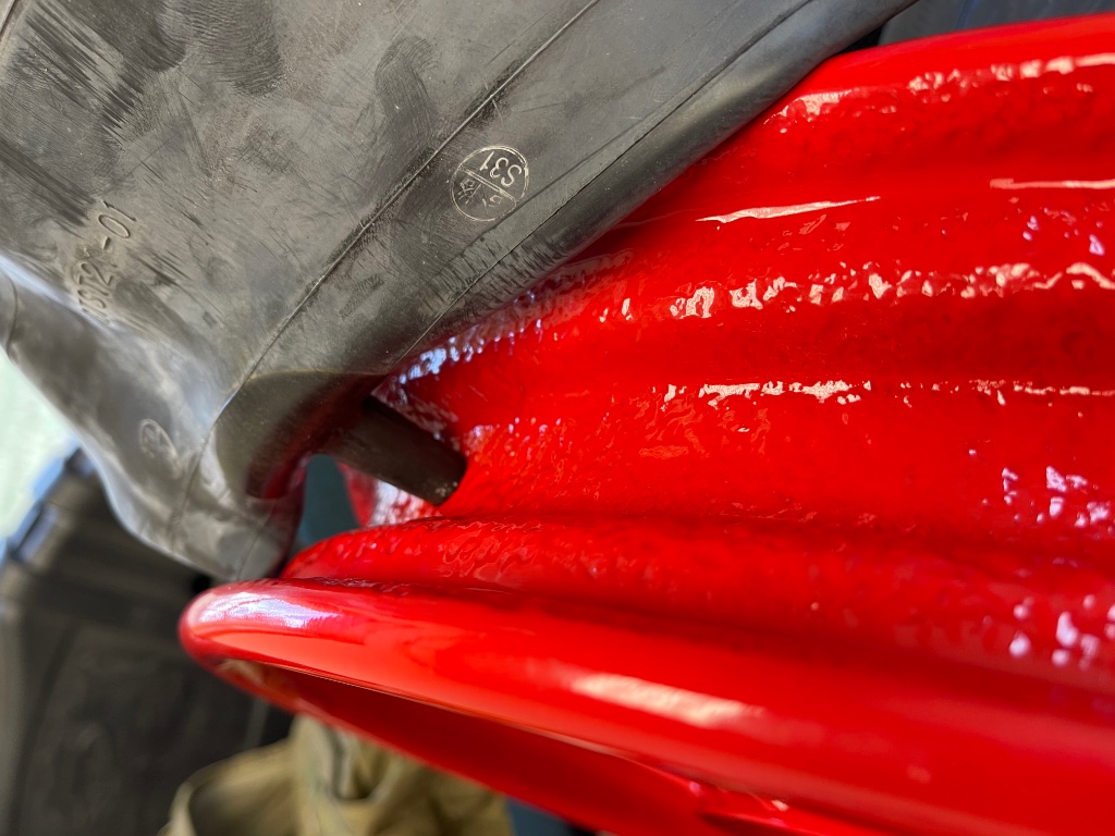

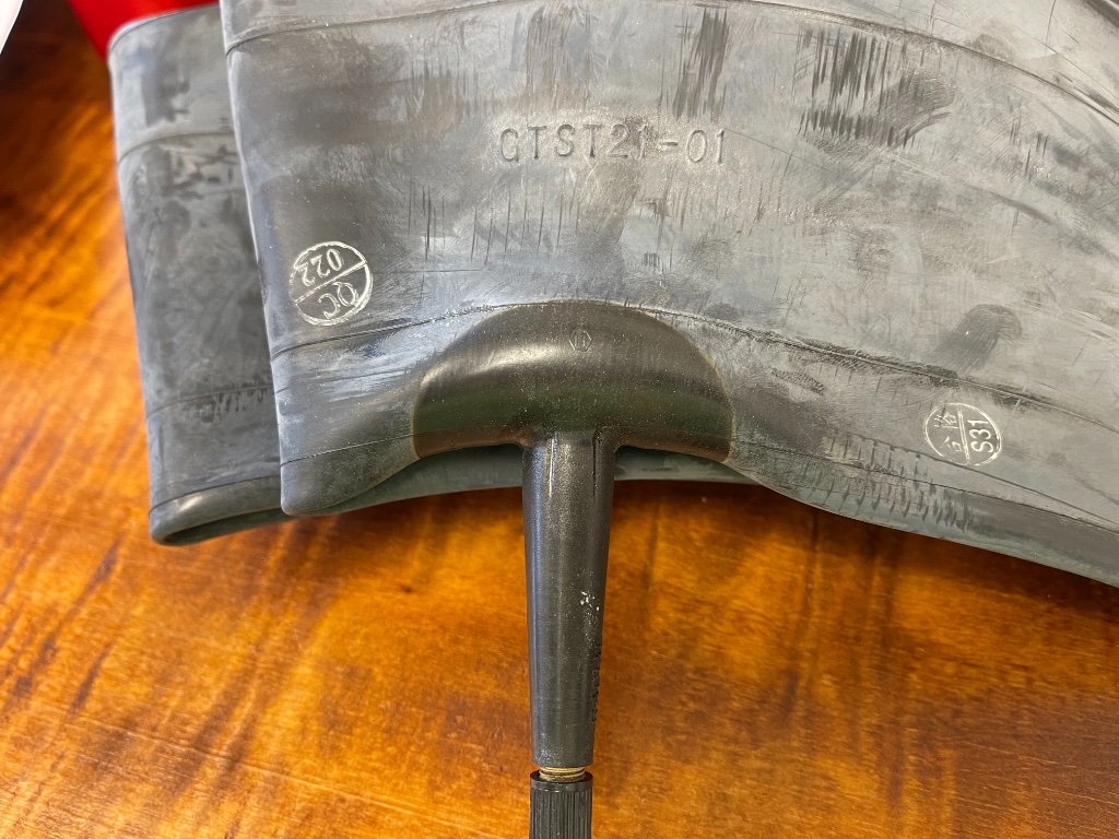

The valve stems seem to be a little large in diameter around the base of the stem. Will not seat all the way in a 21 inch wire rim. Then its a bear to try and get it back out.

I cannot find any country markings on them
Came from Snyder’s
