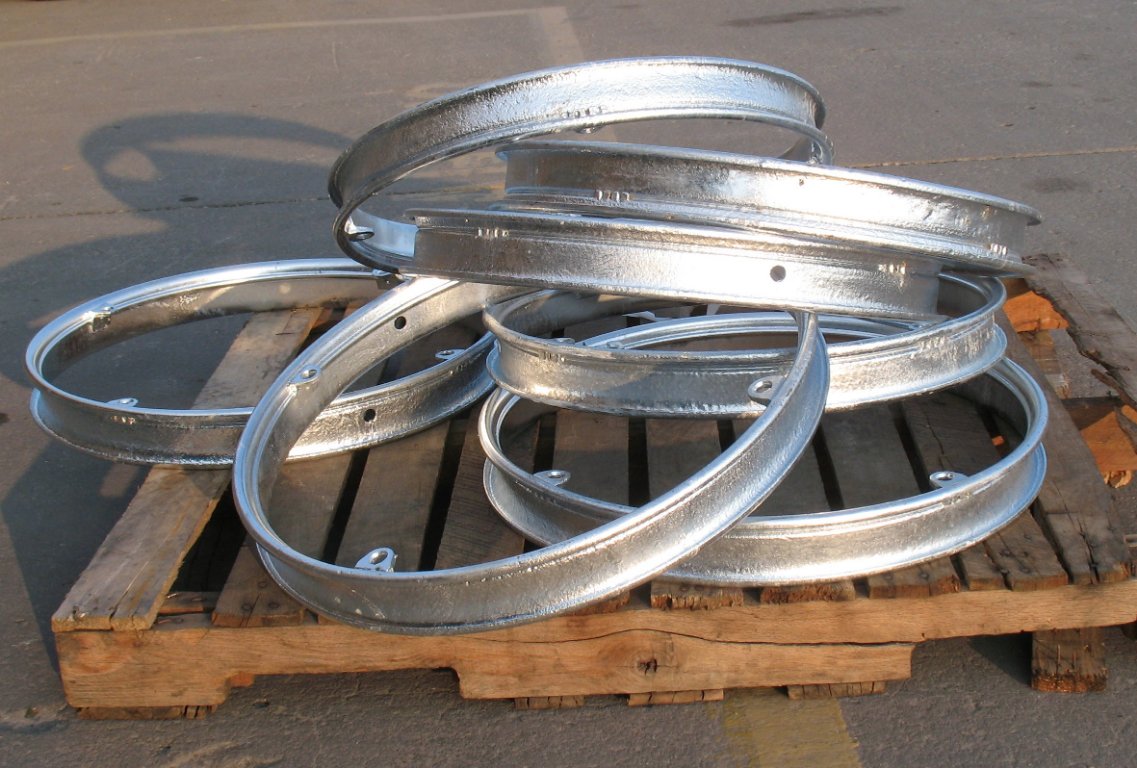

In 2012 I had seven rims hot dip galvanized at the Valmont galvanizing plant in Claremore, near Tulsa, for the minimum charge at that time of about $235. If I'd had more rims I could have had up to sixty of them done for the same minimum. Not too long ago Ignacio got a bunch of guys to pool their rims and have a lot done in a batch for a lower cost per rim. Maybe he will comment here about how that worked out.
