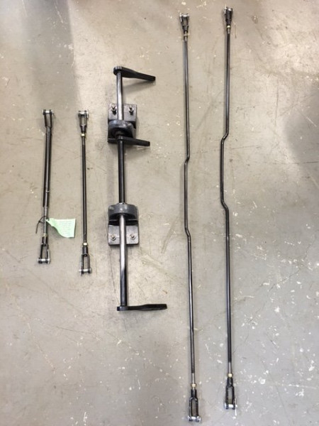

Linkage Made by Richard
His name is Richard Baughman
3771 Auburn Folsom Rd.
Loomis CA 95650
916-652-7827
He makes a very good product and will work with you if you need help.

Does anyone have a picture of Richard’s linkage bolted to a frame? I like the looks of his crossbar but hard to picture where it would bolt to the frame.

I like Richards setup and may try to recreate it. I have a ton of stuff in the way and if I can get those control rods outboard of the frame it would work out for me.
