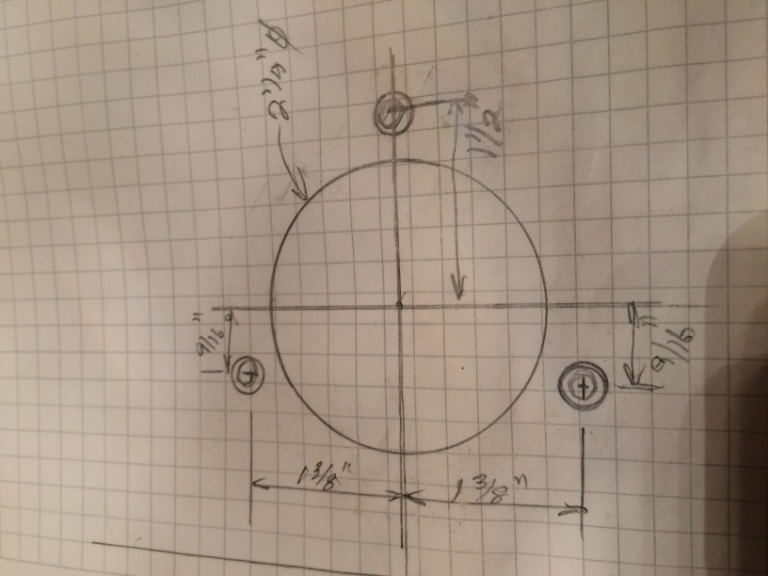

Just wondering if someone has a drawing of this.
I am going to machine a adapter to fit in this place and if someone has already made the drawing it will save me some time as I can just go straight to my digital readout on my drill press.
Thank you for any help!!

The three bolts holes are on a bolt circle, but not evenly spaced. I will have to find my sketches from that project. I made a temporary block off plate.

I’ve played around with Henrys engine machining a lot and have realized that virtually every thing is located by 1/16” increments. A few exceptions (like the camshaft to crankshaft spacing)!!
- Posts: 5563
Re: Generator bolt pattern drawing
When I was making my adapter plate, I found a lot of the measurements were 1/32 too.

The distance of the Camshaft and the Crankshaft is 100 m/m
Even the Bearings of the Generator are in m/m
Why did Henry That . ???
Take Care
Toon

As Les said:
100 mm = 3 15/16 ″
100 mm = 3 15/16 ″

I have been promoting the 100 mm spacing for over 20 years. I figured it out when I found a very nice set of straight cut gears and realized that they weren’t a standard North American tooth, but were a perfect metric tooth profile spacing. So I made a 100 mm “link” for the line boring rig and no longer had any gear mesh issues. Before I ended up buying oversized cam gears half the time to get a decent mesh fit. The problem was that the “vertical” location of the camshaft tolerance was fairly “loose” and most line boring rigs located from the camshaft horizontally. Probably why I have never had a problem with fibre camshaft gears! The 3-15/16 spacing is.008” off. Not terrible but not great either.
To get back to my earlier comments, I had a opportunity to copy Fords factory block drawings and there I found that the bolt spacing were designed for 1/16” spacing. Your block will likely be off slightly as they had a manufacturing tolerance

My speculation is that using the metric gear profile was to make it more difficult for the “after market” manufacturers. It was no problem for Ford to make them to the spec. This is applicable to the straight cut early gears. When they went helical they just adjusted the fit.

Are you saying that the timing gears are Module gears?Les Schubert wrote: ↑Sun Jan 24, 2021 12:26 pmToon

My observation is that the straight cut gears are “modular pitch”. I can’t comment on the helical gears.
