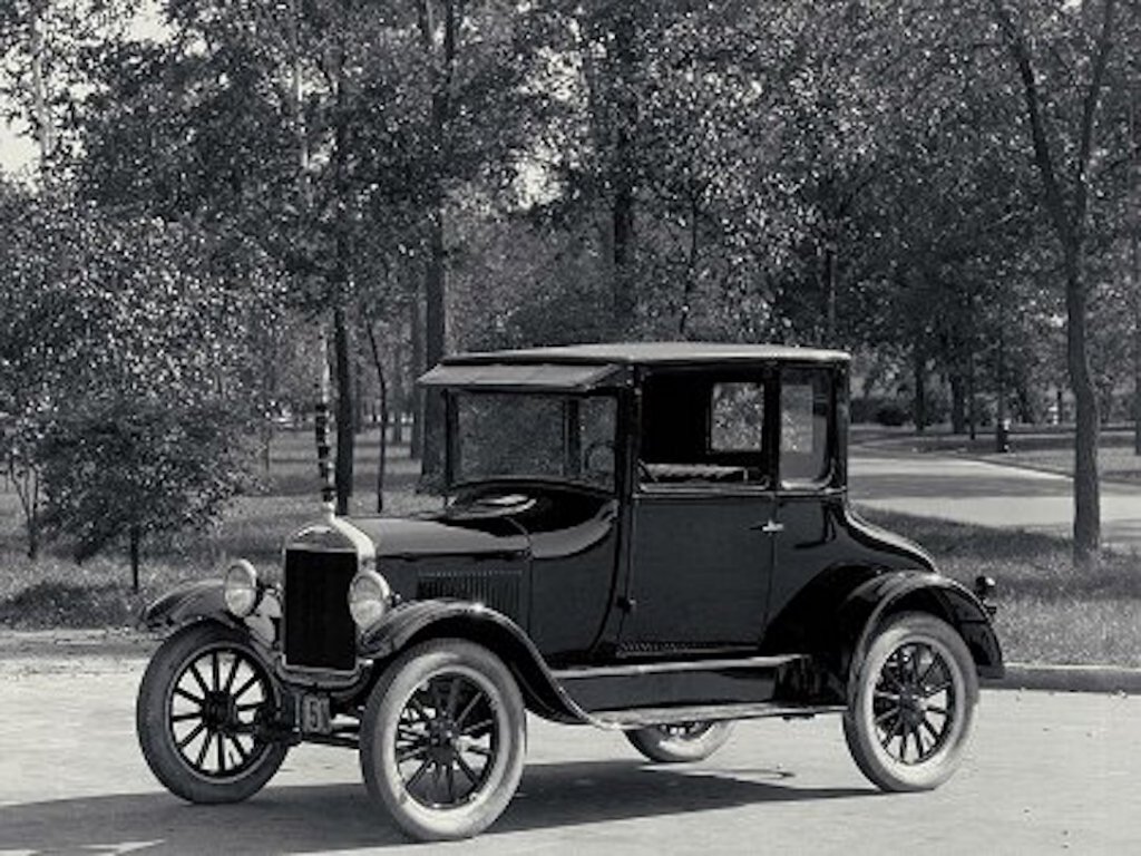

While "natural" wheels became an option in 26-27, they are primarily a modern fad. Before 1926 all wheels were painted body color (black 1913-1925). In 26-27 the stock wood wheels remained black. I believe that's what you'll see in most period photos (not advertising) of Fords with wood wheels. I believe I've seen "natural" wheels in 26-27 advertising, but even there the wheels are usually black.

Natural 21" wheels were listed in the 1925 Ford Price List of Parts, Steve.
