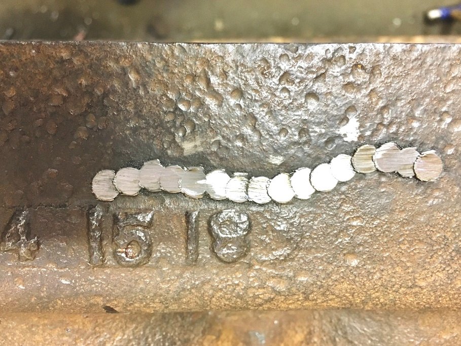

I decided to try the Lock-n-Stitch method to repair a freeze crack in a 1918 block. This crack was an easy fix as the parent material was thick enough to catch plenty of threads on the pins. Here are the before and after pics. I still have to grind the heads of the pins down to the surface of the block and use a de-scaler to reintroduce the original casting texture look.

Next will be the usual cracks on the underside of the water jacket. The block wall is often thinner there and trying to drill and tap a hole perpendicular to the crack won’t be easy due to the limited access area for the drill.

Rich: They make an drill and tap extensions that will help you there. But you are right that blocks are thin at that crack. Dan

Good job! They way I was shown to do it is; install cut peen then do the next one. Also use a sealant on the pins before installing.
