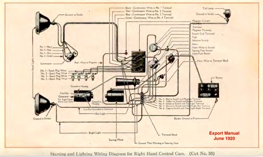

Bottom line up front - does anyone have a diagram and/or pictures of the high-mounted generator and electric starter of a Canadian T from when it was first available (1920)?
I am trying to help the family of a chap whose 1920 Canadian T, with and early electric starter, needs some urgent re-wiring attention. (The owner is currently in hospice care and the family desperately want to get his T to him, correctly finished.)

This older post has photo of wiring diagram for on Aug 1920 Canada Export manual.
http://www.mtfca.com/discus/messages/70 ... 1512380307
Re: URGENT! WIRING ON EARLY ELECTRIC-START T - OR TRYING TO CONTACT WARWICK LANDY (OR SOMEONE WITH CANADIAN SERVICE MAN
Posted: Wed Jan 27, 2021 9:56 pm
by DanTreace
Found the diagram. Here is scan from the Export Manual.
Complete Overseas 1920 Manual at this link:
http://www.cimorelli.com/mtdl/1920/1920comaug.pdf
Click on image to enlarge.

Hi John, It is rare that I miss a forum post and one that mentions my name, but I did miss it! however, your friend David Carver alerted me this post and I will do what I can to help out. Her are some of the RHD generator pics. i may need to scan for from my Canadian manual If I cant find them in my files.

For Warwich - that is the info they were looking for, thank you very much.
