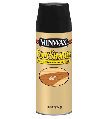

Posted: Thu Feb 04, 2021 12:01 am
by jiminbartow
Check out “Minwax Pecan Polyshades satin” one step stain/polyurethane spray. A very nice color polyurethane. Here are several pictures of the woodwork in the bathroom I stained it with. It will give you a idea of the color. Jim Patrick

Posted: Thu Feb 04, 2021 12:33 am
by ivaldes1
I am not seeing that color at local Lowes. I am thinking Sedona Red...

Re: Hanging Individual Wood Spokes for Painting?
Posted: Fri Feb 05, 2021 12:19 am
by jiminbartow
Sorry to get back to you after the fact. Lowe’s no longer carries the Minwax Polyshades colored polyurethane spray. Home Depot does carry it, but Pecan is a popular color and often out of stock, so the last few times I have needed it, I ordered it from eBay. It takes quite a few coats to attain a nice, uniform coverage. The woodwork in my bathroom required about 6 coats, but the results were better than I imagined. Jim Patrick
