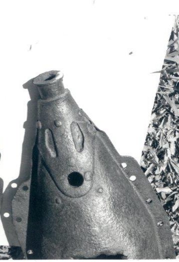

I have a question regarding oil pan styles. I have a Canadian ‘13 built in around September/October of 1912, and documented sold new in Tavistock Ontario in late November of 1912. My car has had a later snub nose pan in it since the 1920’s. You can see it in this photo dating from 1929. I have two, narrow snout pans both with the teacup drain. One pan has seven rivet ears, the other has three rivet ears. Can anyone verify if one of these would be correct for my car? Engine number B-872. I have Bruce McCalley’s book but can’t seem to find the info I seek. Thanks in advance!

Many thanks guys, I tend to think the seven rivet pan is the one I should use but I find that what Bruce wrote was confusing to me. When in 1912 did they start making the change? No disrespect to Bruce’s book but the info is vague unless I’m missing something.

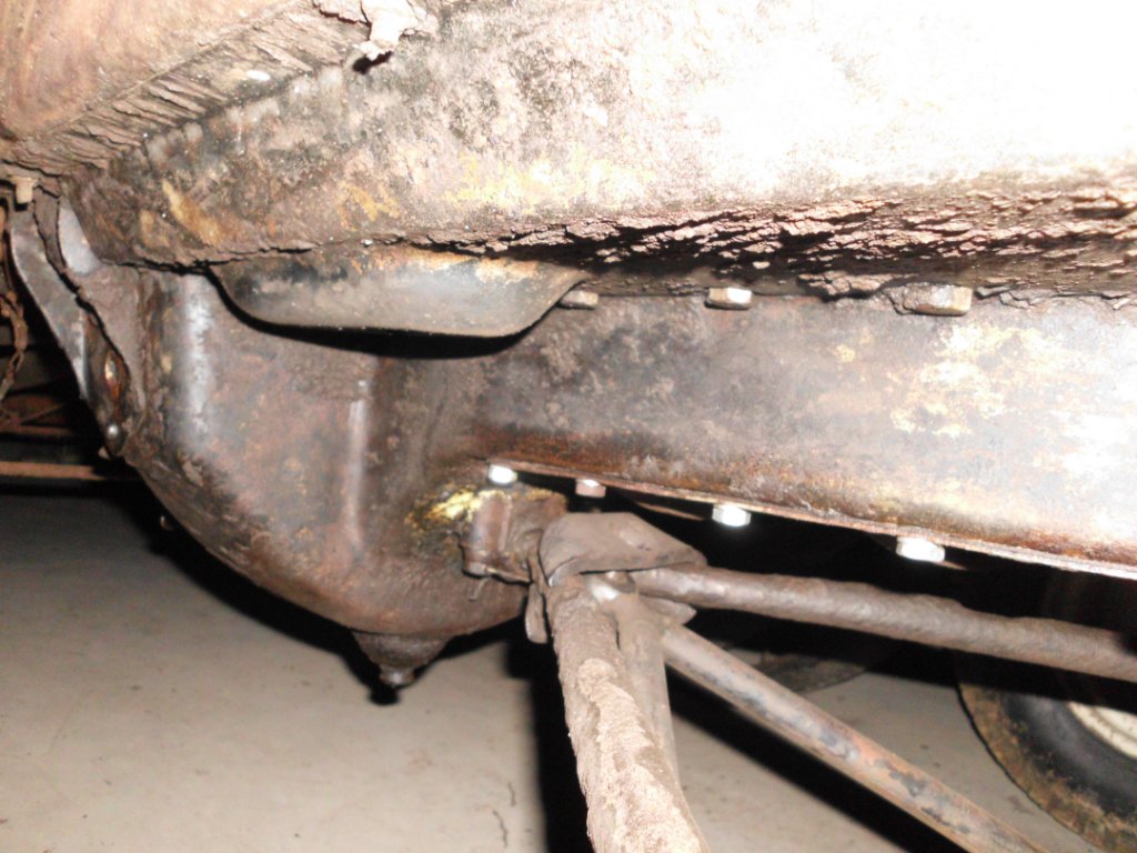

Re: Seeking opinions on 1912/13 oil pans

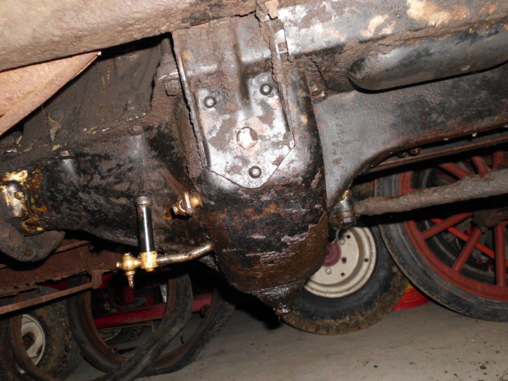

My 1913 engine with casting date in Dec. 1912 has the 3 rivet pan. Second pictures has the aftermarket 2nd tie rod sitting on it that I was testing the fit and did not come with this car.
