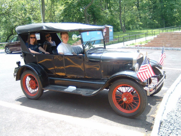

Thank you for the replies. Nothing stamped on the drivers side frame.
Here are some photos of the car.

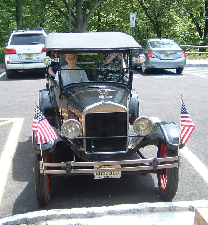

Re: Late 1927 Touring Serial Number Mystery
Here is one from the front:

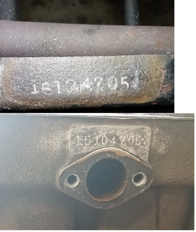

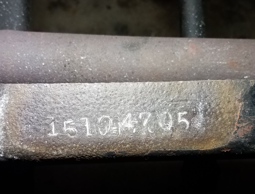

Re: Late 1927 Touring Serial Number Mystery - SOLVED! I thought...
A closer look reveled the serial number was Over Written! Yes, of course! That would explain it, Someone over stamped the original serial number with a later engine serial number. BUT...
On closer examination, they appear to be the same serial number only in a larger, different, font furthering the mystery. Does anyone see something different?
Interesting, the number one in the restamp is the late Model A style frist used in 1931. I didn't look it up but the text says that the Model T engine number on this 27 tourning was from 1928. It could be like what was stated above that a Ford dealer had Ford make a new T from parts in 1928. It could also be that a owner of a earlier 1926 car with out a frame number had the engine replaced by a Ford dealership with a new T engine in 1928 and stamped with the early Ford stamps. Ford dealers would update cars for customers, any business was good business in 1931, so maybe the car was updated again in 1931 and the number restamped with the new style stamps.
Check the tourning body to see if it is a 1926 or 1927 by looking at the door area, etc. Check the current engine to see what the number stamped looks like.
The more we learn about these cars, the less we really know.
Here are photos of the Frame and Engine Serial Numbers next to one another. It appears the 1 and 0 are of the same font of the small frame number stamp.
So this car could have been assembled post Model T production after May 1928, or more likely, it is really a 1926 Touring (without frame serial number) that was stamped with a replacement engine serial number at a later date. How do I check if it really is a 1926 Touring? Any theories as to why the re-stamp with the exact same serial number only larger font?
