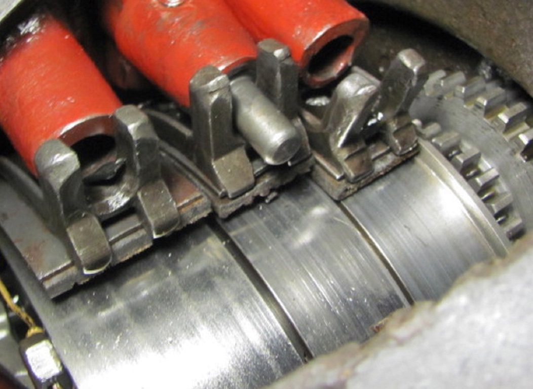

Installed new J&M ductile cast iron drums in my '27, and used new wood linings as choice since the drums were new.
Some wear noticed using wood linings. Had about 6K on these when I pulled the wood linings. The worn low band wood lining was the reason to pull the bands.
Changed to Kevlar, and on inspections after another 3K, drum surfaces haven't changed from this photo of the wood linings being removed. Think the wood is harder on the metal, as only small oil grooves to feed oil. The woven Kevlar drinks oil.
Note lines worn in low drum surface, not real deep, but could feel with fingernail passing over.

thanks dan. thats what i found. could be the wood bands. One of the issues was hard pedal pressure & grabby when hot. I replaced the wood with old scandia. not a fan of wood. i can see advantages in the montanna 500, but not a touring T. (just a personal opinion, hold your fire).
