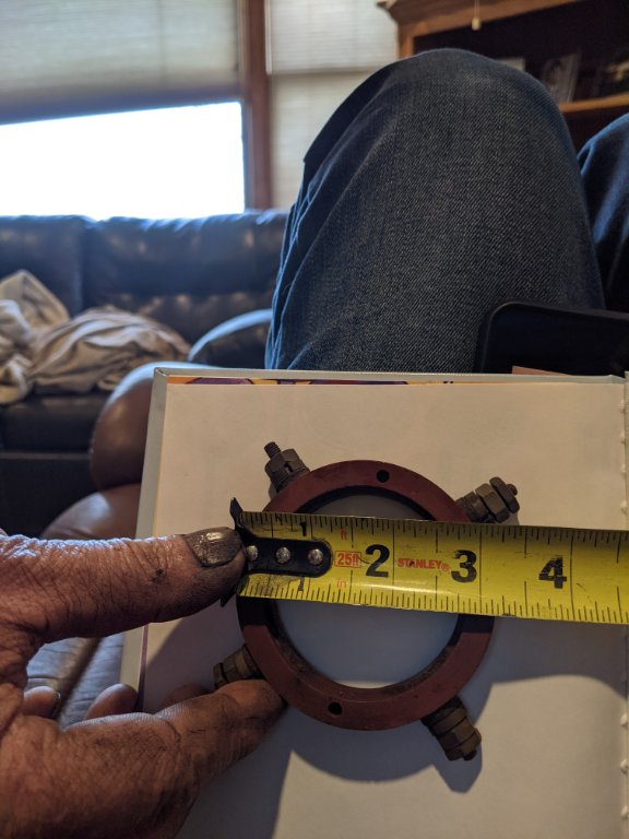

I looked in the barn and found the new one.

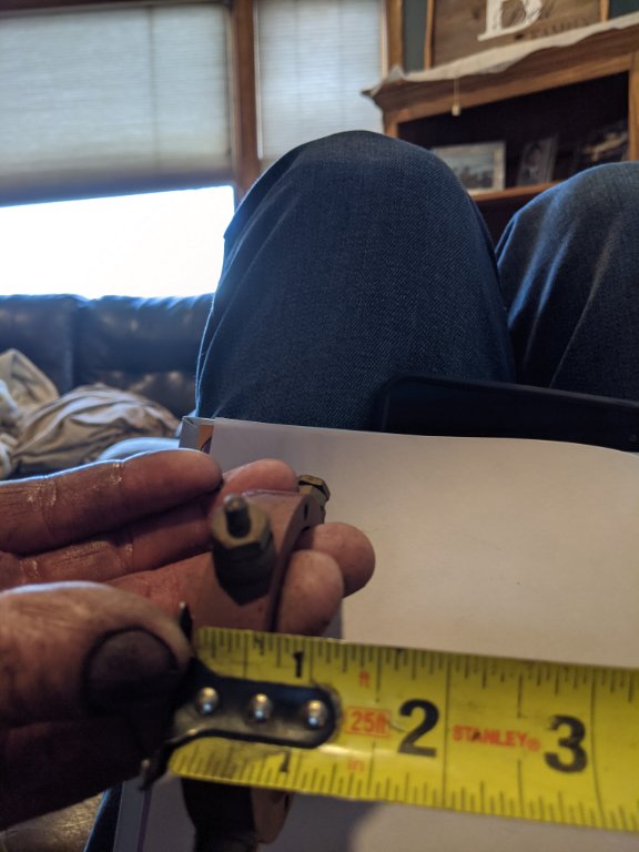

Here's the pictures.

D@mn Joe
You got cleaner hands than I do
FJ
FJ

I have had only one Model T engine show up clean, the rest are oily cruddy messes, the only time my hands are clean is when the wife talks me into a weeks vacation down south!

Joe,
That looks like it. Let me see if I can measure mine here in a few.
Robbie

Joe,
Mine measures 2 13/16 diameter and approx 5/8” deep.

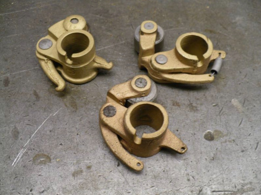

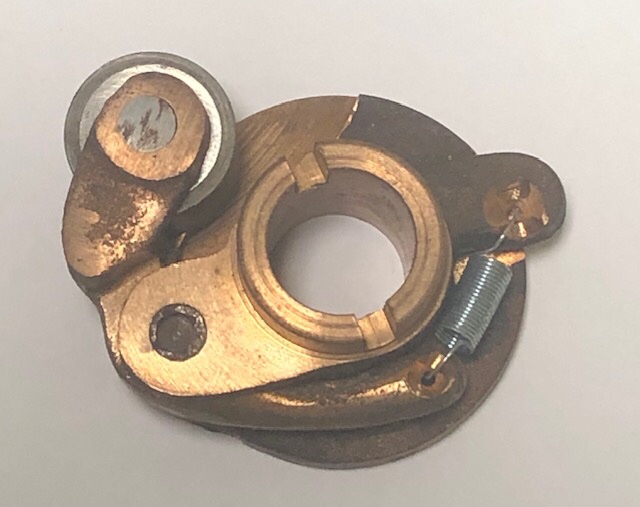

You mentioned rollers. I found a picture of some rollers from a sales site.

I have half a dozen of the brass ones, some have a bigger backing plate.
Tourabout
Topic author - Posts: 273
- Joined: Sun Jan 06, 2019 4:31 pm
- First Name: Robbie
- Last Name: Price
- Location: Cleveland
Re: 1909-10 Brass Timer contact ring
I think the bigger backing plate is what I need
