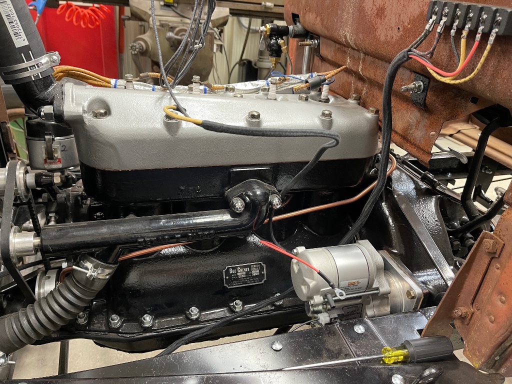

Starting to pull wires on this beast and have a few questions. I have no problem landing all the wires as I have 40 years as a control electrical engineer. I am trying to find pictures of how the wires are run. This is no where near original so I am not being anal. But want to stay somewhere between the lines.
Headlight harness run down the side of block or tuck into the frame channel?

If memory serves, along the hoodshelf. Havnt looked in a while.

A little research and I found I landed the harness backwards. Headlights go on the last 2 terms on the right. That routes them right according to harness length and what Dallas said. Just need some pics of clamps. Or should I use wire ties? :shock:

Factory used clips on the upper frame rail, two-part clip. Bolts and nuts hold them to holes in the frame rail, they jut out from the hood aprons.
Clips too on the fire wall.

thanks guys, perfect. Another vendor order for some clips and clamps
