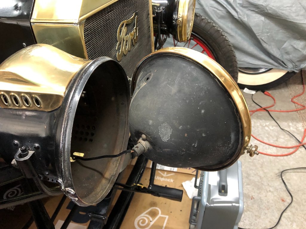

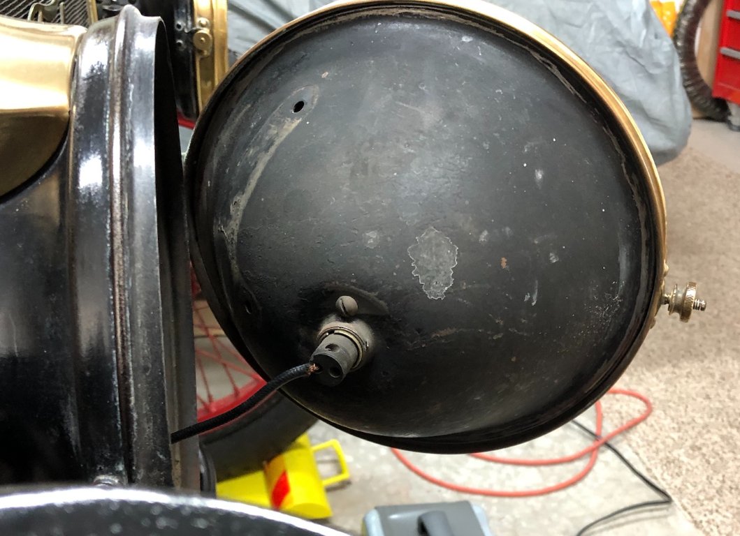

that bucket looks like a stock black t headlite. any evidence of rivet holes on the bottom? lenses may be common assorted size replacements. have seen that name brand in stock black t buckets. woody was quite the guy to adapt stuff, as you know.

I'll have to go out and look over the headlight bucket carefully to see about the rivet holes. I'll shoot a few more pictures while I'm at it.
The headlight doors are pretty well battered. The rest of the brass (outside of the horn) is pretty nice. I wonder if the damage might have been done while "adapting" the headlights?

Well spotted John! Here are a few pics shot minutes ago:
The holes can clearly be seen along with the dirt that was under the mounting bracket. How early were these buckets used?

Those buckets are approx. 1917 or 18 to 1925. The ones from '16 to perhaps '17 have the adj. screw on top of the socket, i.e., in-line with the mounting bracket.
