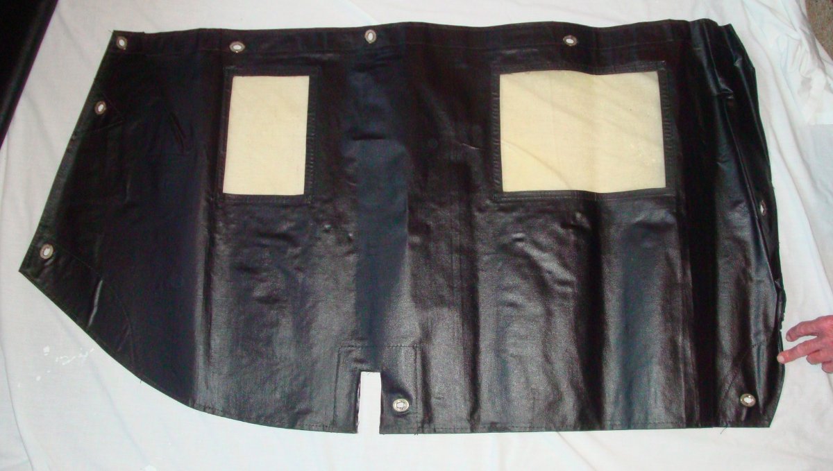

The windows in the rear top curtain and side curtains were made from celluloid.
Some folks refer to them as isinglass but that is incorrect. True isinglass is made from fish bladders. Mica glass used in wood and coal stove windows is also referred to as isinglass. However, I don't believe that mica glass is flexible like celluloid.
Below is an original, NOS side curtain from a set for a touring with its original celluloid windows.
