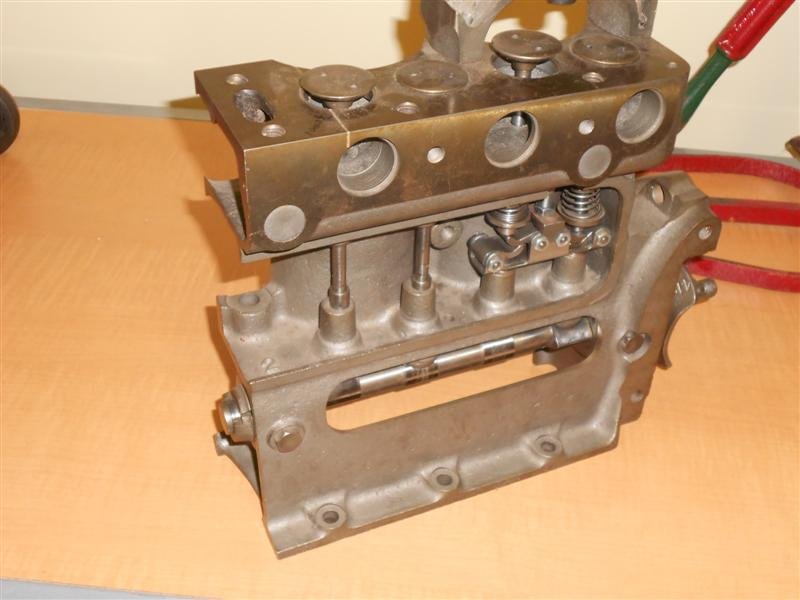

The device for holding the multilifts in place and lubrication seems to be the big issue. The very colorfull pictures show a beefed up version as for this picture. Running a line from the hogshead or drip oilers may solve the lubrication issue
Craig.
