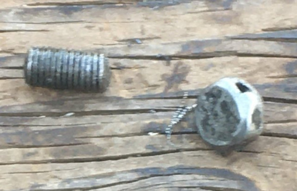

After careful study I determined that a failed original bolt conspired with a lot of worn parts to cause a significant problem.
broken bolt
broken bolt
This bolt was in the ring gear holding it to the differential casing. It sheared off and was held to the ring gear by it's safety wire. As you may see in the photo it lived that way long enough to get tumbled like a rock at the beach... rounding off the edges until the safety wire broke. The bolt head then found it's way between the pinion and ring gears. This snapped the pinion in half and broke the Woodruff key and the keyway of the driveshaft (on the taper). The force was so great that the differential casting broke. This sudden jam caused the triple gears which were on worn pins to jam teeth together (because of looseness on the pins) and snap off a triple gear tooth and allowing the triple gear to go out of time seizing the transmission. The result was broken shafts and bushings on the low and brake drums, trashing the drums. The bushing on one triple gear shattered and bent the triple gear pin trashing the flywheel.

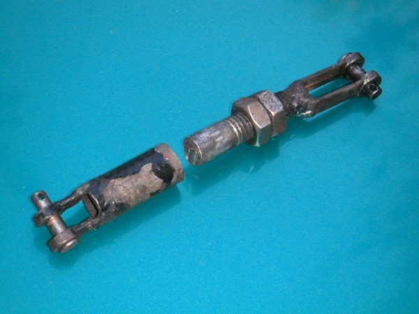

Prior to redesigning the slider I used the one which I purchased with my accessory brakes. After using it for a short time I found that the brakes faded in use. The problem was that the 5/16" all-thread rod used in compression to push the brake mechanism failed by bending in the middle. You can see in this photo that even after straightening the inadequate rod retains a bend.
Vendor designed slider

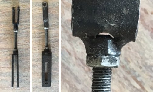

Next you can see the design I came up with to replace this setup. I used 1/2" galvanized pipe, a 1/2" bolt, and two clevis adjusters. They were welded together and replaced the manufacturer slider. The pipe piece slides over the 1/2" bolt piece and is adjusted with the jam nuts. There is more than enough of the 1/2' bolt inside the pipe to keep the interlock from buckling. I have been testing this design for over 15 years and probably over 30,000 miles.
Horlick design slider
This design is both adjustable and so stout that it continues functioning under the forces encountered in the most severe panic stop.

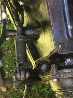

Horlick Slider in place... one week after "incident"
Please look at your interlock and see if it is assembled with parts like 5/16" all thread which are meant for tension NOT compression or which have poor insufficient welds. If you have such an item on your car I urge you to consider upgrading to something safe. If you are thinking of buying an interlock please evaluate your choice and forgo one which has light, possibly inadequate design and construction.

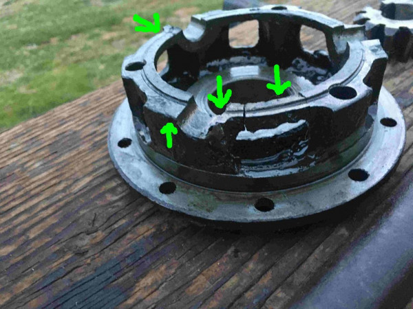

cracked differential carrier
There was enough force to break the differential carrier casting in several places.

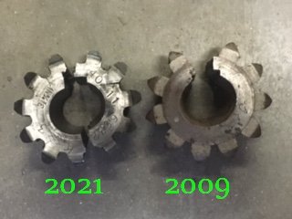

broken pinion (removal date)
Here we see the pinion placed in around 2001 and broken (coincidently about 100 yards up the same hill from the current incident) in around 2009. On the left we see the pinion used for about 12 years (2009-2021).
