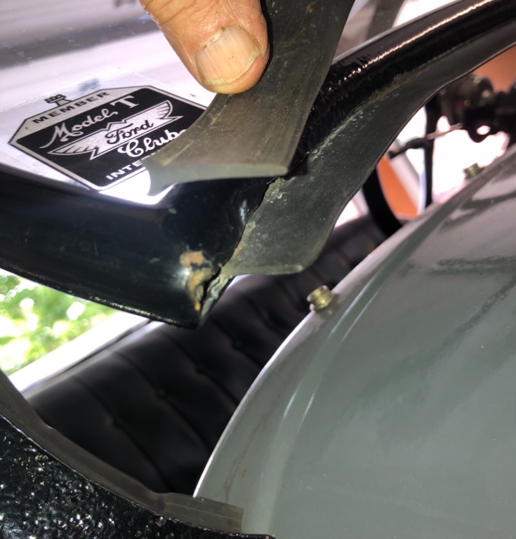

Not sure I was clear with my question. This is a 26 Roadster, so the bottom half of the windshield will tilt up and give easy access to the rubber. I just don’t remember whether I pushed it in after the glass man installed the glass.

That T rubber is pulled into the slot of the lower frame. No need to remove the seated glass.
May be easier with lower frame out of the T as that piece of rubber can be pesky. Use some silicone paste on the rubber
‘ T ‘ portion to allow it to slip in better. And the channel has to be free of rust and debris too. The ‘T’ enters a oval hole about an inch for either end of the channel, those openings are there for that purpose.

Thanks. That's the info I needed. Looking at the windshield, the areas where the rubber would start to slide in have been filled with paint. I'll clean that out and see how it goes.
