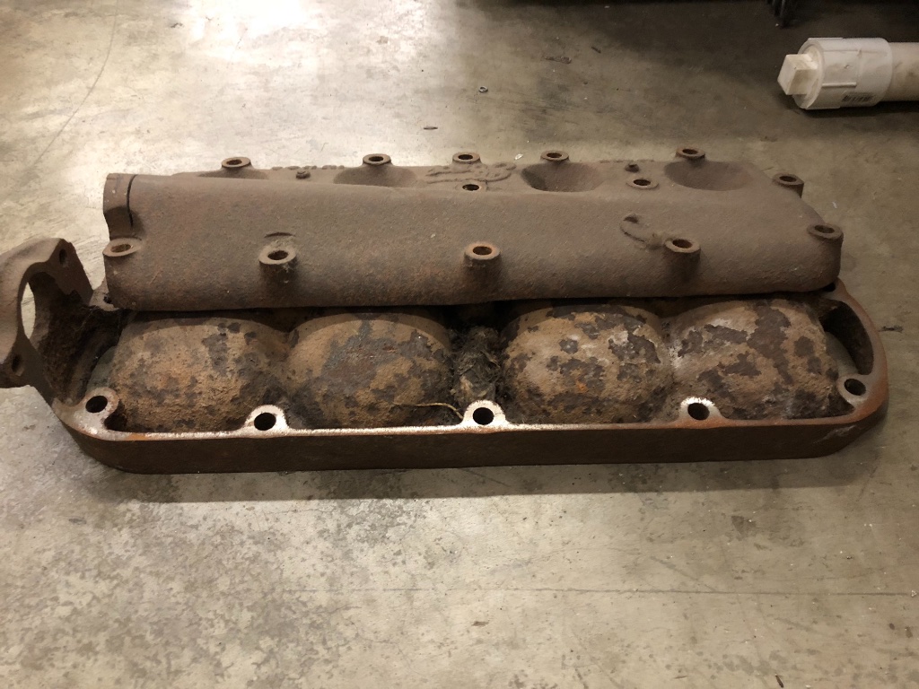

by Henry K. Lee
The best spot is here Danny!
Hank

by dmdeaton
I like the cutaway head! That’s awesome

by Brian D
Where you aware the MOUSE plug was in the head when you cut it?
Never would have occured to me a plug like that.
I guess you could flush forever and not get that out.

by Henry K. Lee
The engineer gave his life! LOL
I did multiple temperature checks over the years and found there is a heat eddy right where I marked it. You really want "True" head temperature when it comes to engine performance. As another find, MotoMeters are off by up to 10-15 degrees. Just in my observations.

by dmdeaton
The wall thickness on the head is a lot less than what I would picture in my head. But I have a lot going through my head😳
Hank, I should have thought about this before we bolted the head down

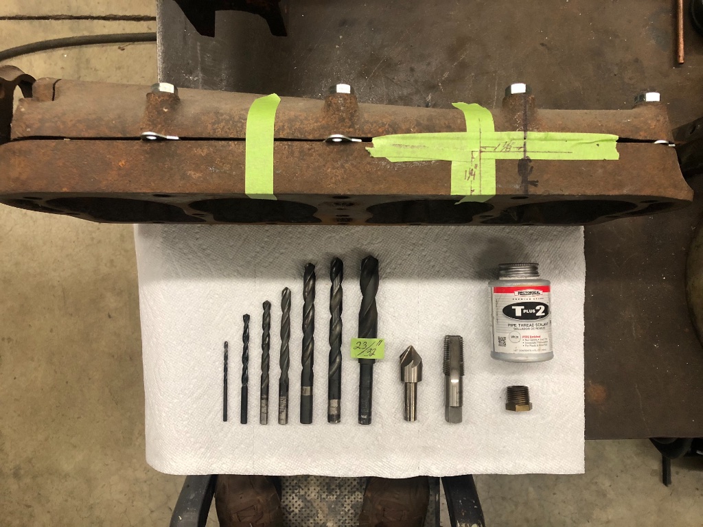

by Henry K. Lee
To easy to do it even with the head on. Vacuum cleaner and pilot drills working your way up.
