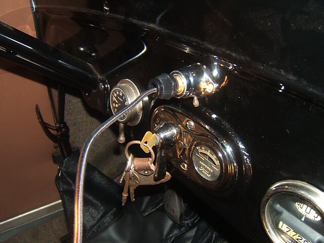

Here is the steering column support bracket on my 1926 coupe. I suppose if the hole pattern matched up, it would fit. Jim Patrick
