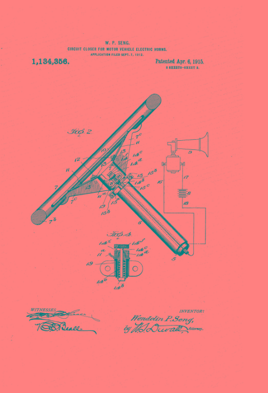

Anyone have a Seng Steering Wheel that could let me know how to get the horn ring working? I'm pretty sure I have a missing part that is right below the wheel that contacts the horn ring.. There has to be a sliding part that contacts the ring on the wheel.

Frank,
Yes I saw that link. The part I must be missing is below the wheel, seen in the first picture and the fifth picture. I looks as though that part is covering the steering gear case. I am asking if that part somehow is able to go around the gear case. I wouldn't think a steering wheel manufacturer would supply a whole new steering case.

Is this any help? Non-T but maybe similar.

Here are pictures of the part that Rich is missing
