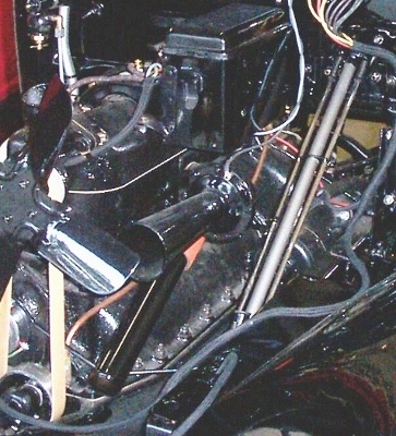

Very little room on the passenger side of the 26-27 with the coil box and standard Ford buzz horn.
closeupbig - Copy (477x525) (363x400).jpg (120.16 KiB) Viewed 2738 times
If your Sparton is the large motor drum Model A type, those can be exterior mounted, you could hang it on the 26-27 headlamp bar.
If the motor Ahooga horn is smaller type, about the only space in the engine compartment is on the driver's side. Make a bracket of heavy steel (lots of vibrations, so flimsy thin angle isn't best.) Go high enough to keep exhaust manifold heat from baking the horn. This is a motor horn mounted to engine head bolts, seems a good strong bracket....this is one way.

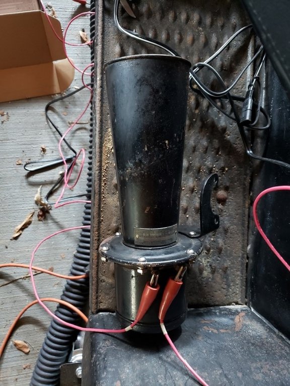

Post by Mikey1968 » Fri Apr 30, 2021 11:24 am
Here's what I have. Note the bracket it came with. I also ordered a Model A bracket on the chance it might fit and offer an option.

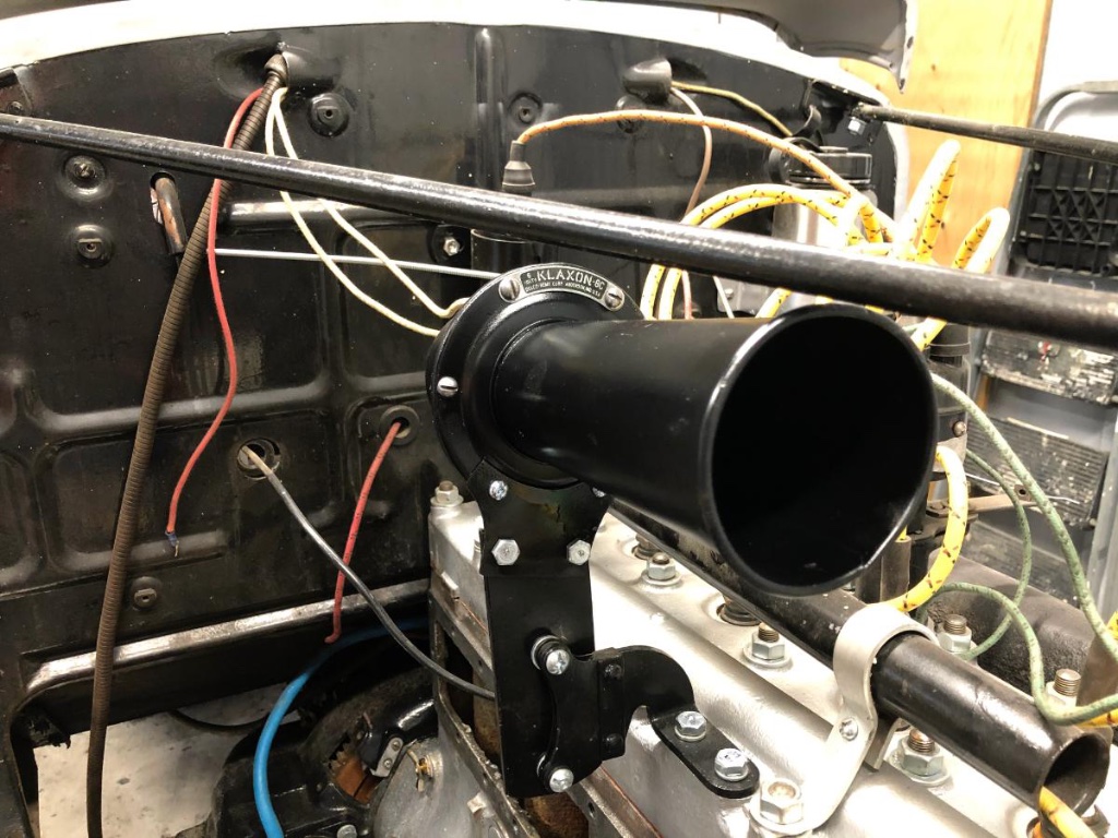

I’ve done exactly what you are proposing on my ‘26 coupe. I originally had the proper goose horn on my car when I bought it, but was shocked and disappointed when I first heard it after I hooked it up and tried it. Needless to say, I did not like it, so I eventually found a 6V Klaxon ahoogah horn, which I loved and, as a voice, fits my T much better. I installed both the goose horn and the Klaxon ahoogah horn, but after awhile, even though the goose horn is the proper one to use, I took it off and am using the Klaxon horn exclusively because I rarely used the goose horn, for the Klaxon horn elicited more smiles and reactions and I just like it better. The ahoogah sounding horn is what most people associate the T and most cars from the 20’s with, even though it is incorrect. Jim Patrick
PS. In answer to your question...My goose horn came with a raised bracket that allowed me to bolt it down using two of the head bolts. Each horn was wired separately and each had a button mounted on the steering column next to eachother.
