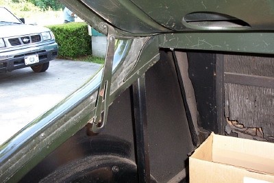

Highland Green is the color for the Pyroxylin (lacquer) painted closed cars, beginning July 1926. The paint is a light shade of green and is satin in finish. These weren't rubbed lacquer to a gloss, just as sprayed on. Ford didn't want to add hand polishing to this faster way of painting the bodies.
This lacquer paint in Highland Green, was Ford M-633. The earlier enamel was Channel Green, Ford M-392.
There was a lacquer in Channel Green color, but was known as Drake Green, Ford M-637
Also a lacquer in Commercial Green, Ford M-608
Based on the available lacquers in these colors, one would assume enamel paint colors were gone by 1927. Except of course black enamel oven dry, that was on chassis and sheetmetal.
Original Highland Green from a 1927 coupe
