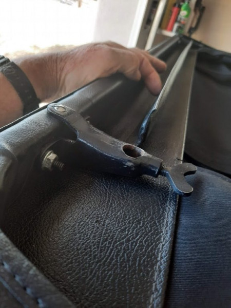

I am installing a top on my 24 touring. Has anyone installed a kit from cartouche? Iv watched a few videos and there kit install seems to be different then how clastique installs there kit . Particularly how the wind breaker installs at the windshield. Has anyone installed this kit and have pictures and pointers on there ? Thanks in advance

I did a Cartouche top on my 23 touring, and yes the windbreak flap did not work like they showed in the instructions. I installed it to where the flap that is double fabric just covers the top of the windshield. I have the top down now, I will try to get some pictures later today to show you how I did the front flap.

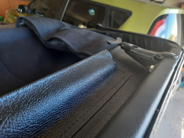

Re: One man top install
Here are some photos of the windbreak on my Cartouche top. The front bow is covered in the vinyl wrap, then I put the large part of the windbreak on the top of the front bow with the stitching of the flap about 1 1/4" from the inside of the bow. Then I put the pads and straps on then the top deck was the last thing. I put a thin strip of wood molding in the flap that covers the top of the windshield to make it stiffer, and does not flip over the top of the windshield at higher speeds.
One thing that I found is that the straps need to be tacked to the second and third bows. The instructions did not mention tacking down there. It makes it a lot easier to put the top down. I just stand (hunched over) in the back at the center and lift the second bow out of the U brackets, then reach out and grab both of the loose ends of the second bow and push them down and forward and everything falls in place on the saddles.[image] [/image]
