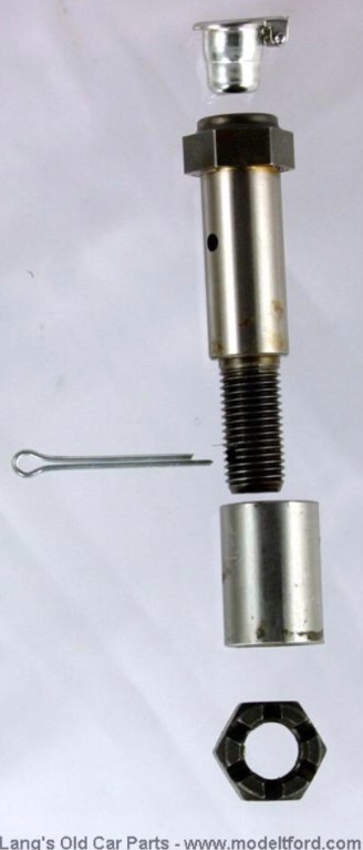

The 17-27 tie rod bolts and oilers look like this:
That's it right there..Thanks..Now I know..
