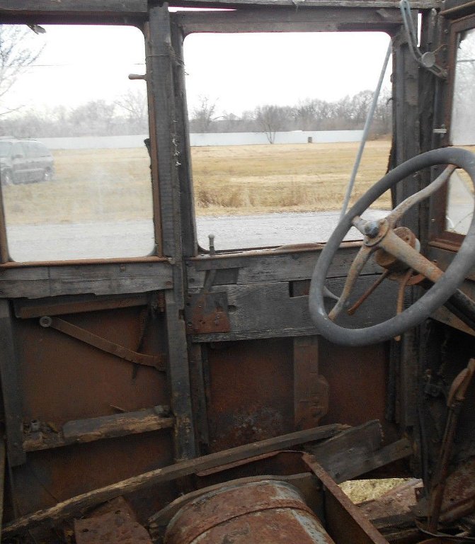

Re: Help Identifying These Doors
Posted: Tue Jun 01, 2021 4:16 pm
by Rich Eagle
This photo shows one of the wood framed doors.
